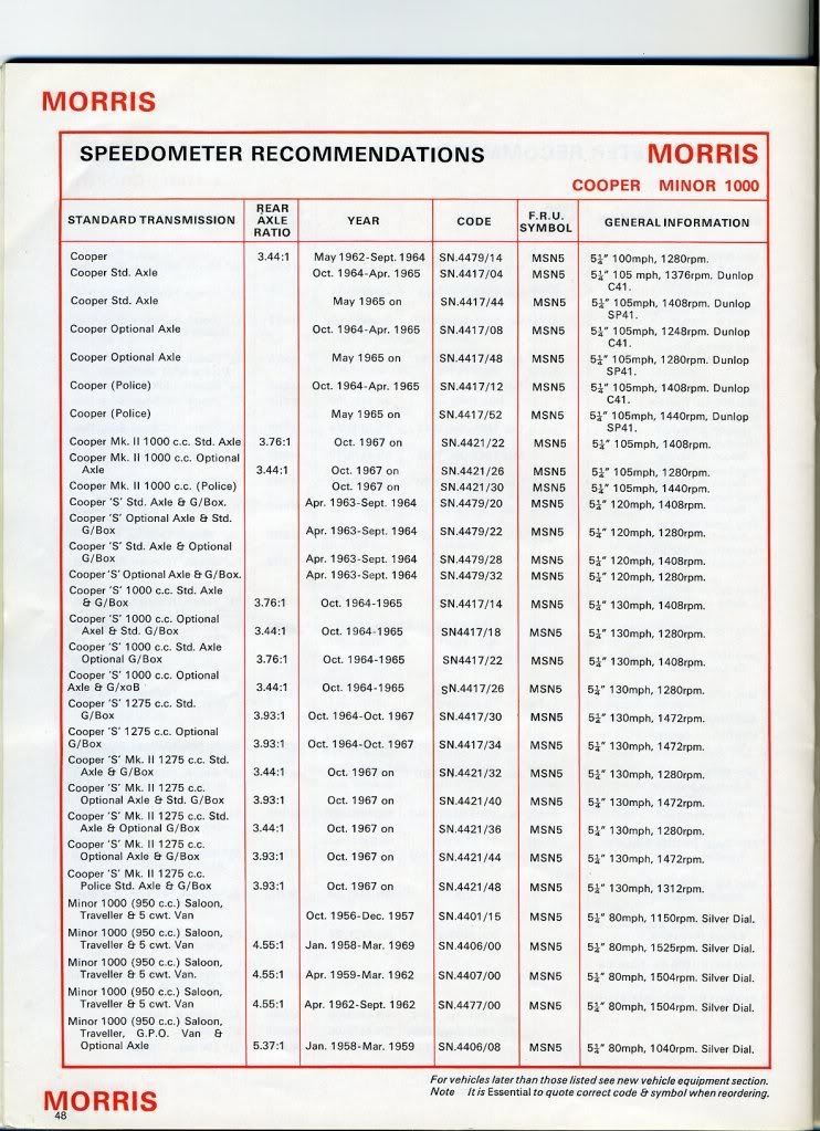

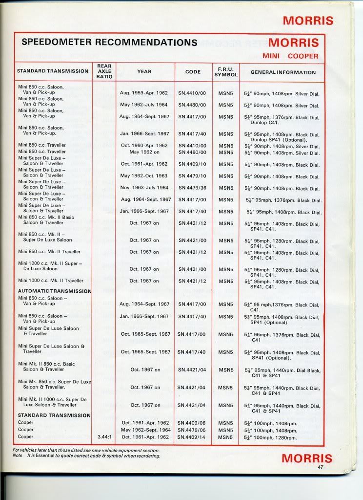

This is the Smiths UK catalogue. May be of some use.
