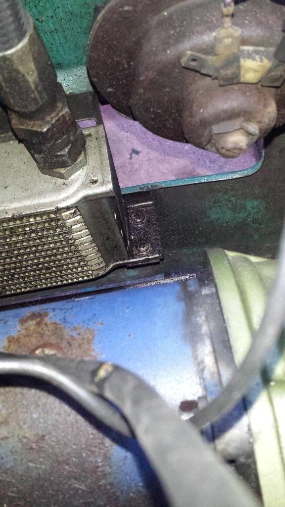

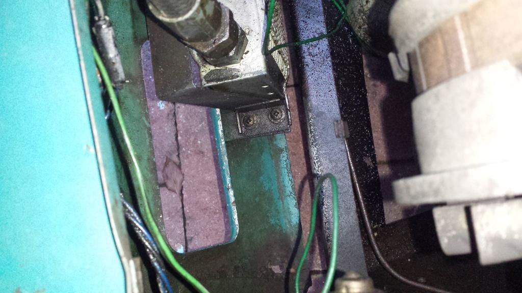

Mick that all looks correct. EXCEPT!! The bent tabs on the bottom of the cooler are actually spot welded to the mini body, not bolted like in that picture.
And the oil cooler and bracket bolts to these tabs and the top part of the bracket bolts just behind the number plate.
I will see if I can grab a couple pics of mine on my car.

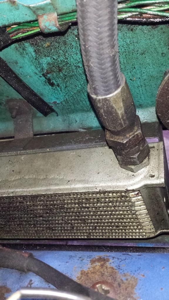

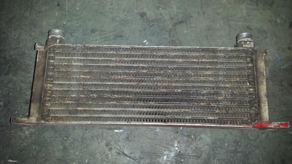

Here are some pics. Not the best or the clearest. But hopefully you get an idea and answers your problems.

Just comparing against the cooper S one shown in Micks link. the holes up the side of the oil cooler are on opposite ends.
The Cooper S has them closest to the hose end, where as my GT has them closest to the base.
Just something interesting (That's from a 12/71 GT). I have another 11/72 GT I will have to check the cooler from it.
PostPosted: Sun Jun 15, 2014 5:40 pm
Huh, that's odd :)
They're probably there to stop water pooling inside the case. It may be they can be flipped by the guy doing the manufacture.
