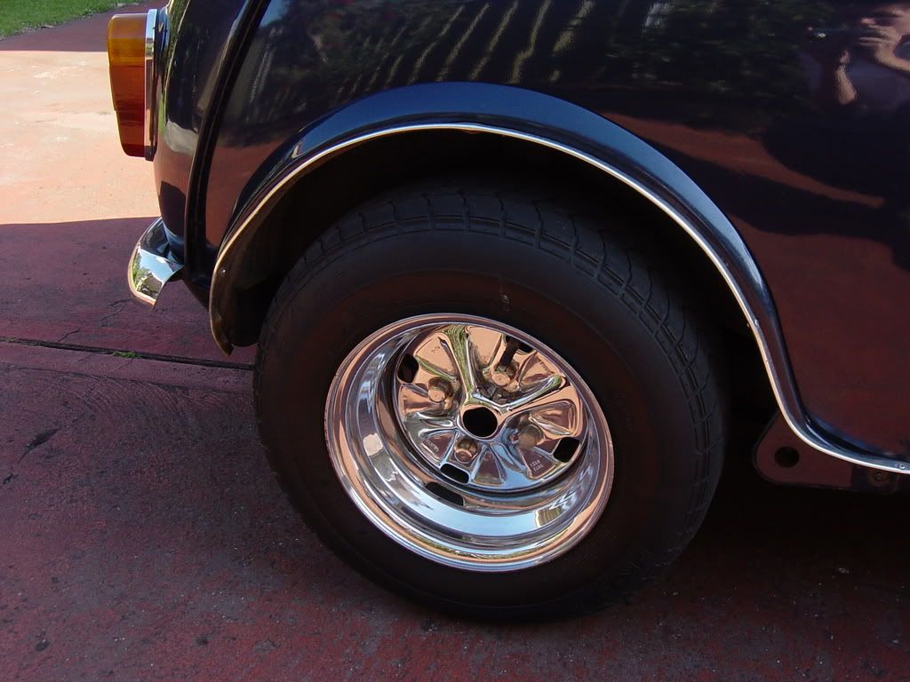

 Post subject: Re: Re-chrome wheels
PostPosted: Wed Jan 21, 2015 7:24 pm
Posts: 2690
This is an old pic when they were still nice and shiny.
