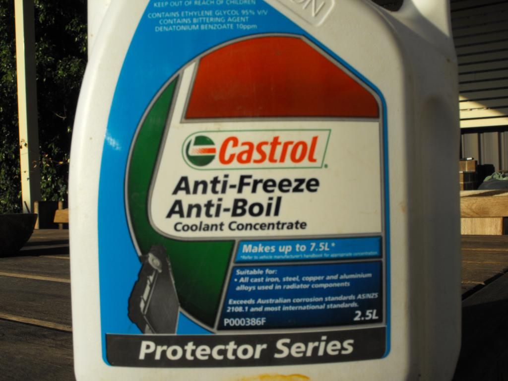

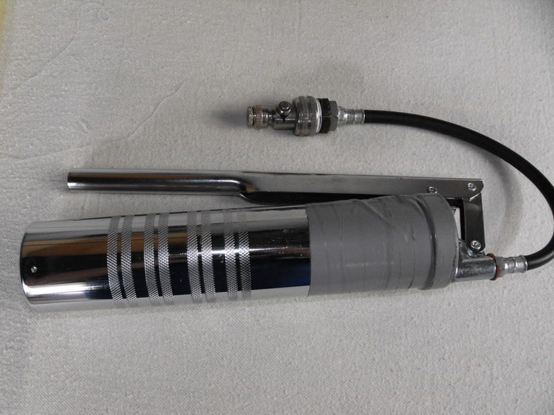

After the first Rylstone Classic , i decided to lift my car up a bit to eliminate the constant scrubbing of the flares with a full load of fuel , luggage & spares , so after a bit of research i came up with this concoction ,
I ended up putting a 70/30 mix of Castrol Coolant , and De-mineralised Water in it with the aid of my homemade Hydro Pump , which worked a treat :wink: ,
