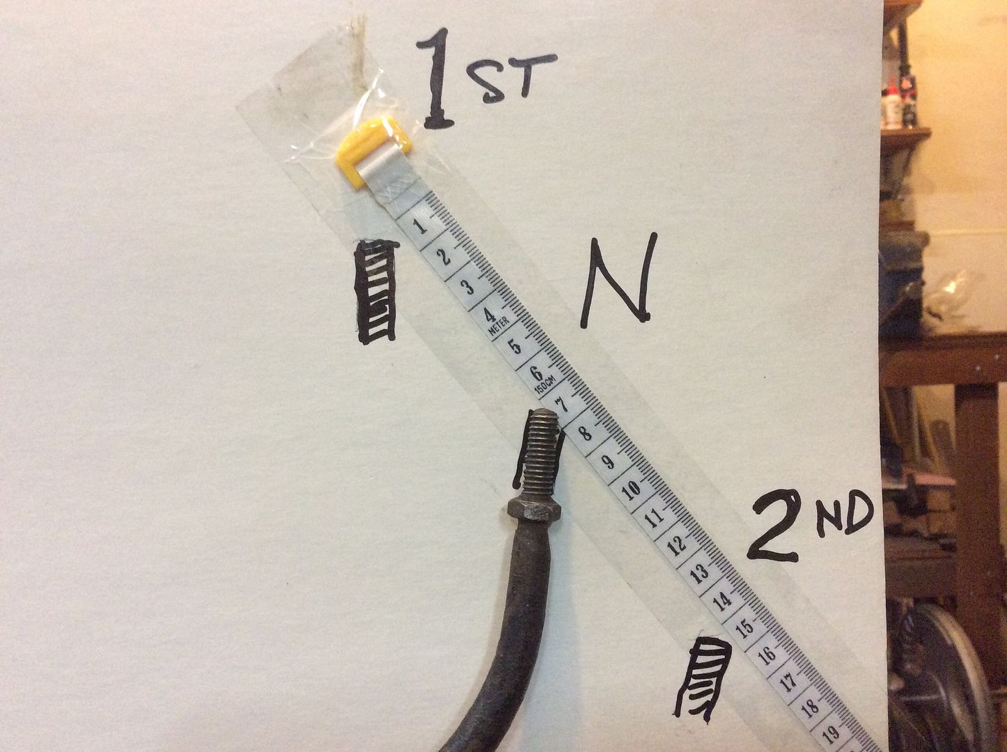

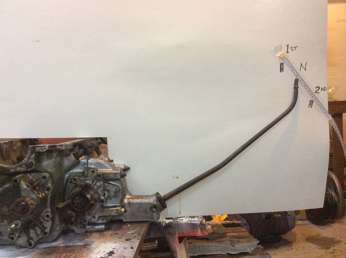

Well, I have fitted an 850 diff housing to a 4 synchro box.
Put the gear lever in and selected all of the gears.
I was surprised by how little travel is required by the "pudding stirrer" compared to what I am accustomed to with my current Rod Change box.
Here is what the pudding stirrer achieves.
By comparison my rod change is about 180mm 1st to 2nd and it is a much shorter lever ?
