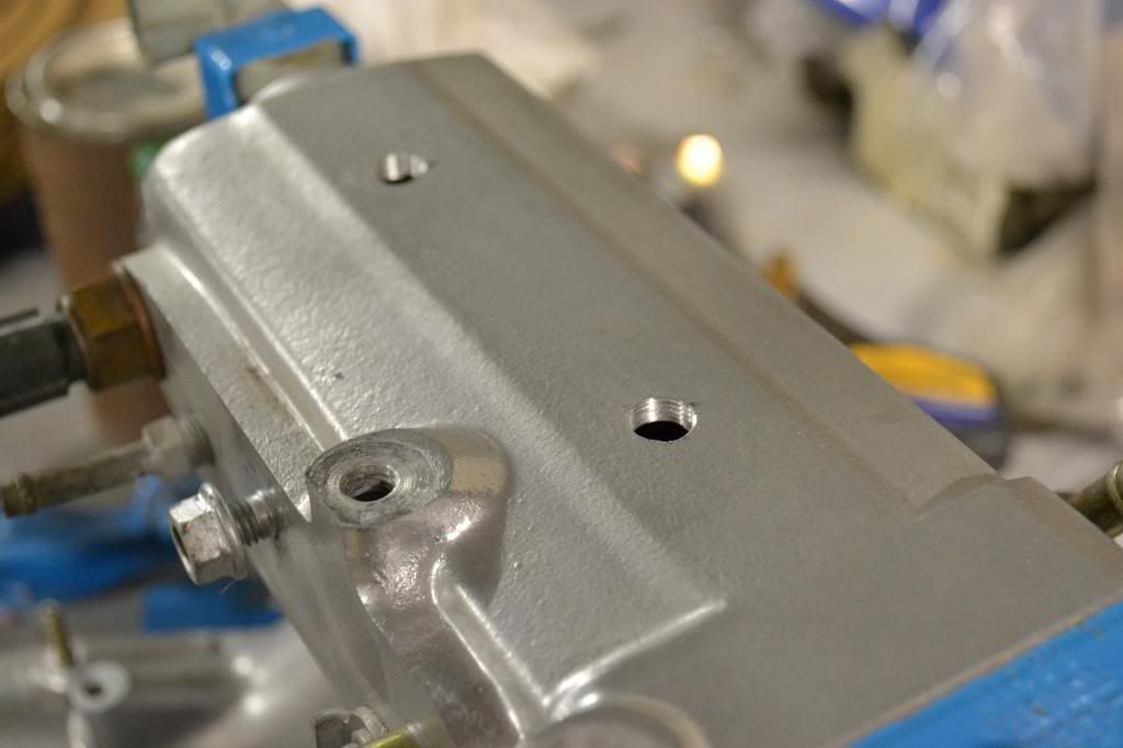

Anyway, back to the Mini. Drilled and tapped the inlet manifold for the 1/4 NPT thread. Blew out the IM and tested the thread - all good!! Nozzles should be here next week.

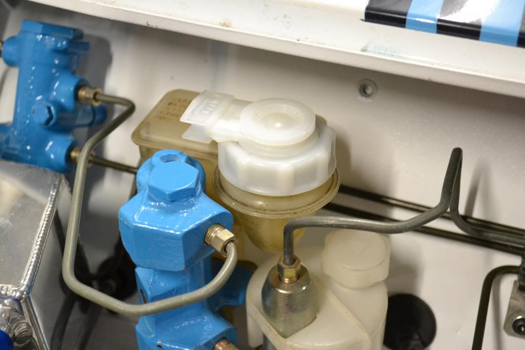

Also, when I ordered the bushes and other stuff from the UK, I ordered a brake reservoir cap that has the float level in it, to indicate low fluid level. Now this cap does not fit straight on to the Aussie late model master cylinder. For those wanting to do this you wll have to drill out the anti-spill lip with a 32mm hole saw. In discussions with the Engineer, we will use the integral break-fail switch and the low fluid level switch in parallel so we get a visual indicator in both conditions.
I havent installed the brake fail switch yet, need the master cylinder to be 'balanced' before installing it.

Is a brake fail lamp necessary? I mean, it'll be obvious when the brakes don't work!
Low fluid is good, I get that. :D
PostPosted: Sun Feb 03, 2013 10:23 pm
You can get and indication of a 'imbalance' condition (differential pressure condition front to rear), and still have brakes.
Its a double-redundancy feature and I would much rather have than have not! The Engineer thinks its a great idea too, and if he's happy, I'm happy!! :D
Wouldnt you much rather know what's going on with your braking system???
PostPosted: Sun Feb 03, 2013 10:42 pm
Yeah ofcourse - I'll have a fluid level lamp too, but getting an indication of front / rear imbalance seems a lot harder to my mind than what you have planned.
:D

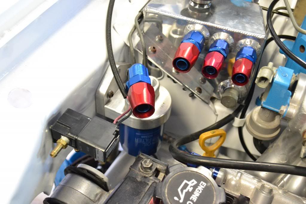

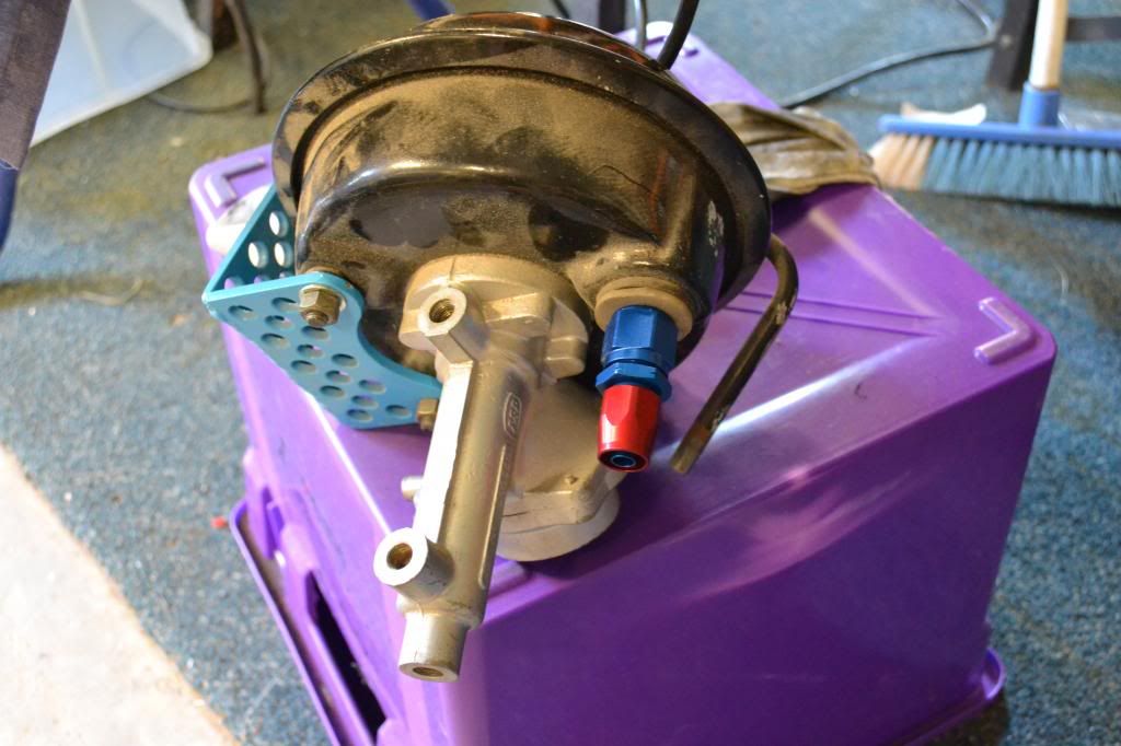

Installed the GReddy boost contol valve, as well as finally getting all the fittings for the oil catch can. The oil filter is installed:

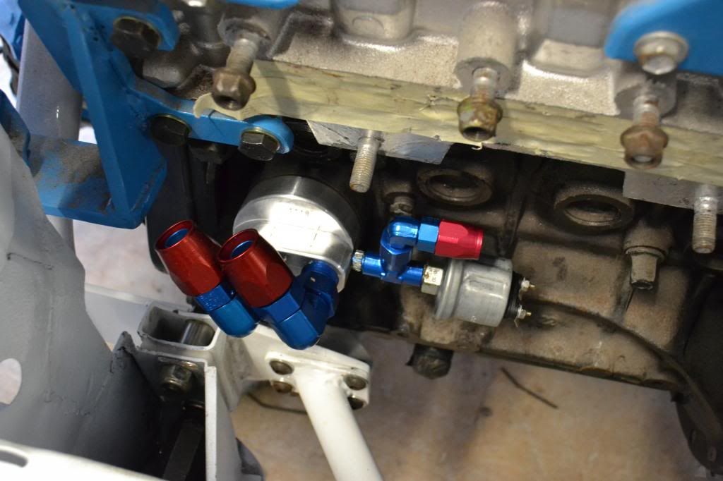

Machined a take-off for the oil feed for the turbo from the oil filter relocator. It also feeds the sender unit which gives oil temp and pressure:

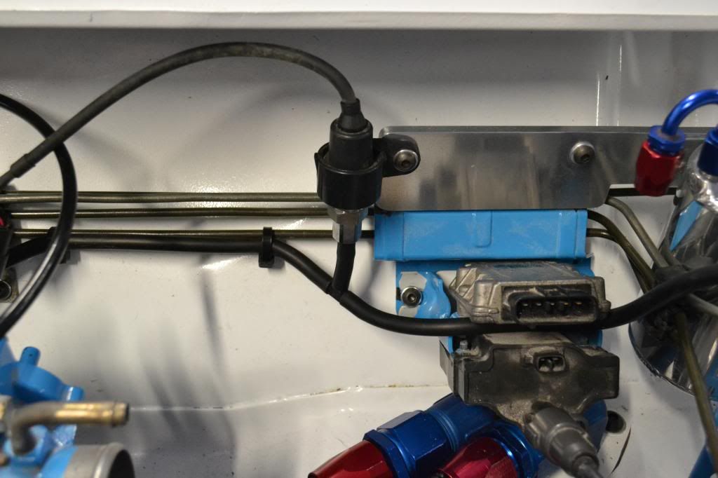

Installed the GReddy vacuum sensor:

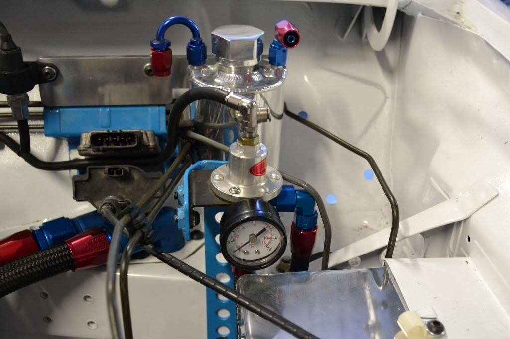

And the Sard rising rate fuel pressure regulator, in its old position, as it is better located here:

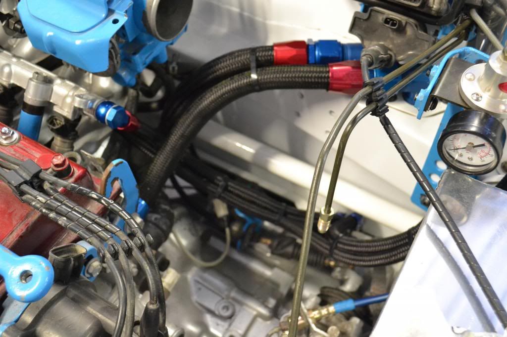

Also, all the heater and fuel lines have been run and fitted off. This space is where the brake booster lives:

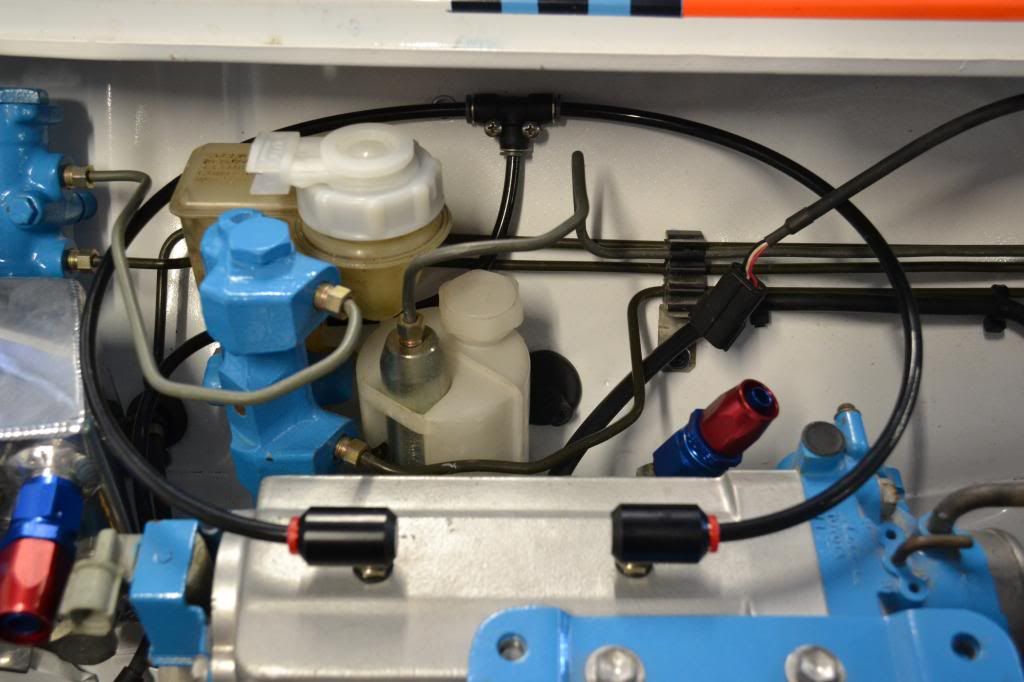

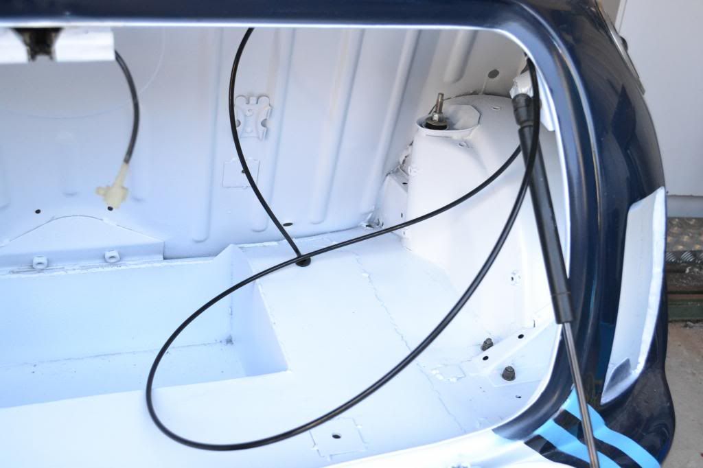

And finally run the hose lines for the WMI, and terminated them at the nozzles which arrived mid-week. They flow around 200cc/m at 200psi which is more than enough for the size engine. In the background is the vacuum take-off for the booster:
And finished running the water line into the boot:
