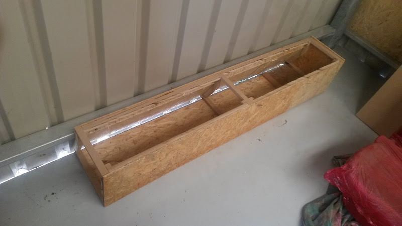

The latest work in my garage before the Mini work restarts is setting it all up - workbench, small paint booth, lathe bench (all custom made) and general cleanup. In the last 4 months, I've had enough get spare time to install most of the all the lighting & power outlets. The lighting finally allowed me to making progress at night rather than just wait for weekends. So far, the workbench finished...
It's an ALL STEEL frame weighing in at ~120kg for just the frame and 200kg+ with all drawers and tools stored. It's made from second hand 76x38mm patio tube with a 150x50mm tube as the front so I could have a 50mm overlap for clamping items to the bench if needed. Overall dimensions are 3.4m long x 0.8m deep. It's screwed to the two steel columns by only 4 Tek screws but the whole bench does not move at all.
The drawer boxes were made also from second hand MDF I sourced from a cabinet maker from their cover sheets. All drawer bases are 18mm MDF while the sides and fronts are 12mm MDF.
The benchtop is made from 18mm MDF (screwed to the steel frame) with a layer of 3mm masonite over the top. I also oiled the masonite which involves pouring and wiping any kind of engine oil over the board, let it soak it in (I used about 1 litre in the whole area!) and wipe off any excess. Finally, paint the frame and drawer front lot in enamel paint and then figure out where all my tools will be stored - which will probably evolve as I start using the garage a lot more.

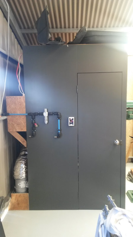

I have also (mostly) finished the paint booth. It's not something I will use frequently however I have more than enough room in my garage for it and it's very useful when I do use it, not to mention preventing any overspray on everything else in the garage. I did all the proper calculations to size the filter areas and fan size, as the booth I had at my old house always had an issue with not enough air flow.
I took advantage of an error that the grano made when pouring the slab and decided to use the 20mm gap between the slab & wall sheets as an exit point for the outlet. Two manifolds later and I had this (with the fan between them)
I clad the booth inside & out in 3mm MDF and painted it the same colour as the workbench. The roof is 6mm braceboard so I can store miscellaneous items on top (dashboards, door trims, timber sheets)
The booth is a cross-draft design with four filters across the width of the whole booth. This is the interior (note I have not built the bench inside yet) showing the exhaust manifold and the 200mm duct opening leading to the fan.
On the exterior, I have some compressed air fittings. The compressor will be located inside the booth with an flexible air line running from the compressor to the RHS of these fittings. Air will travel through the filter/regulator and then either travel down the LHS of the fittings back into the pant booth (for paint gun), or out to the air lines that run around the perimeter of the entire workshop. The switch next to the door will be for turning on the interior light, fan & compressor without having to enter the booth. I also have a small ball valve (red handle) in these fittings to purge the system of air when I've turned the compressor off. The fan on the left is a 635CFM/474CFM (high speed/low speed) axial fan.
