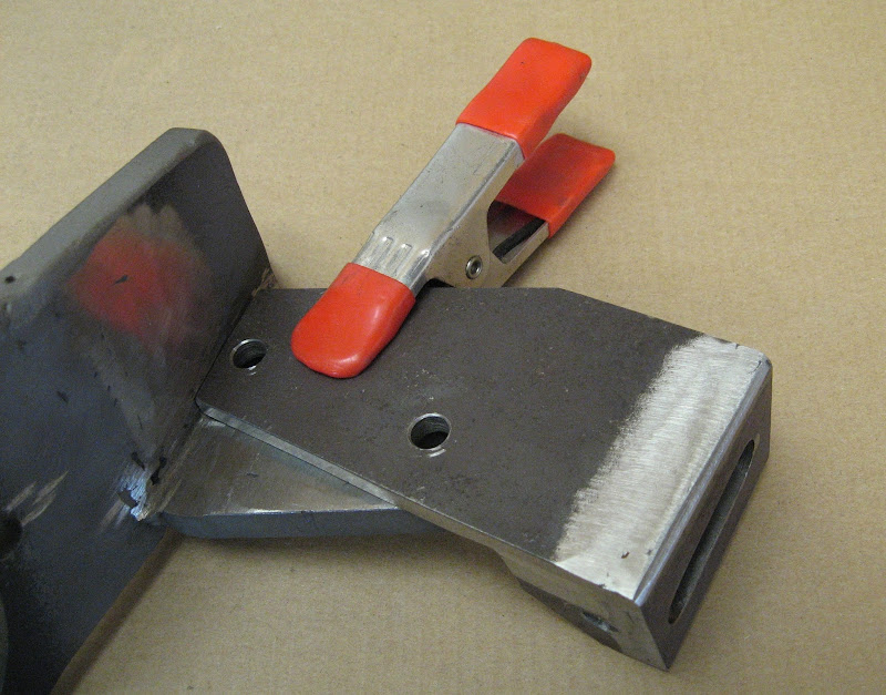

Each corner of the WRX seat sliders have pressed steel brackets attached by heavy duty rivets so the first step was to remove these brackets by drilling out them out. I used a spot weld drill bit to help with this.
The new brackets for each of the seat corners were made from 5mm steel and I have used Class 8.8 high tensile bolts all round. I re-used the rivnuts in the cross brace piece; and the steel plates / captive nuts that I welded into the floorpan from when I had the Swift seats. As expected, I was limited to how low I could fit the seats and still provide clearance for the seat sliding mechanism. The new mounts :
The rear mounts been welded together with some flat steel bar. I was concerned that the inner bracket would pull up on and fatigue the floorpan metal (due to the steep angle of the bracket) if it wasn't tied to the other rear bracket. FYI, the inner bracket is the same height as the outer bracket despite what it it looks like in this photo.
With the seats fitted, they (just) touch each other in the centre of the car but that was the compromise of being able to mount the seats rearward to get legroom, and clearing the rear storage bins. My wife & I sat next to each other in the seats and despite the seats touching each other, the space between us was still reasonably good. Headroom was okay too, even once the headliner takes away 30mm or so.

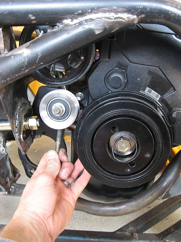

On the original engine layout the alternator was used to tension the belt that ran around the main crank pulley, water pump and the alternator. Since the alternator has been relocated (standard for our engine swaps), a new tensioner had to be fabricated for the water pump.

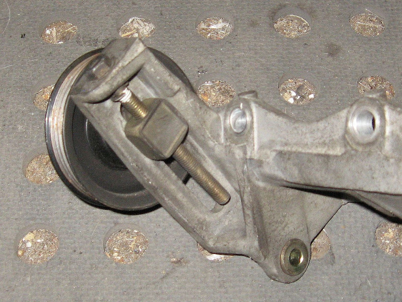

I found a tensioner at an auto wrecker (I can't remember what car it was from) so I could adapt it for my needs.
I purchased the smallest 4PK pulley that my local auto parts store could provide (72mm OD), but this was way too big to fit between the other pulleys and subframe tower.
I outsourced some work and got a custom pulley machined at a 20% smaller diameter of 58mm OD and used the same bearing size (6201RS) as the pulley I bought at the wreckers. This fitted nicely and seemed like it allowed for some reasonable vertical movement to tension a belt.

The final tensioner bracket design (rear view), made from 6mm steel which allows for approx 30mm of vertical adjustment. In the photo below, there is a custom spacer between the pulley and bracket. I had to make a few spacers of differing widths before getting the alignment with the other pulleys just right.
The bracket in situ. The layshaft bracket is not fitted here so I used some spacers behind the tensioner bracket to simulate the thickness of the layshaft bracket

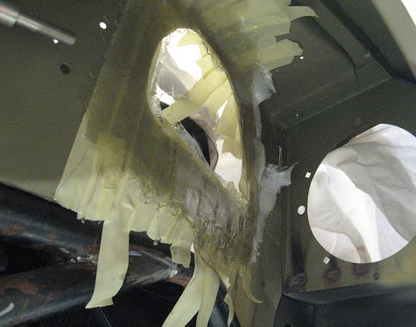

Still in the wheel arch area, I was concerned with the alternator being exposed to road debris and water so I wanted to make a cover for it. I applied some masking tape to the wheel arch opening where the alternator protrudes into the arch, and laid some fibreglass cloth to get the shape
Once dry, the piece was then trimmed and with the alternator installed, I measured and marked how far out the cover would need to be to cover the alternator.
From there, some flat fibreglass sheeting was wrapped around the above "ring" and I added an step to clear the wiring plug that splugs into the back of the alternator. I also made sure it does not interfere with the headlight bowl.
The cover (yet to be primed/painted) is bolted to the inner guard with a few bolts and will be sealed with some neoprene foam. My only concern now is with the alternator half of it enclosed in a cover, will it get enough airflow to prevent it from overheating on a hot day. Should I drill some small holes in the rear of the cover or make a small duct to feed the alternator with fresh air?? Will this be enough?
