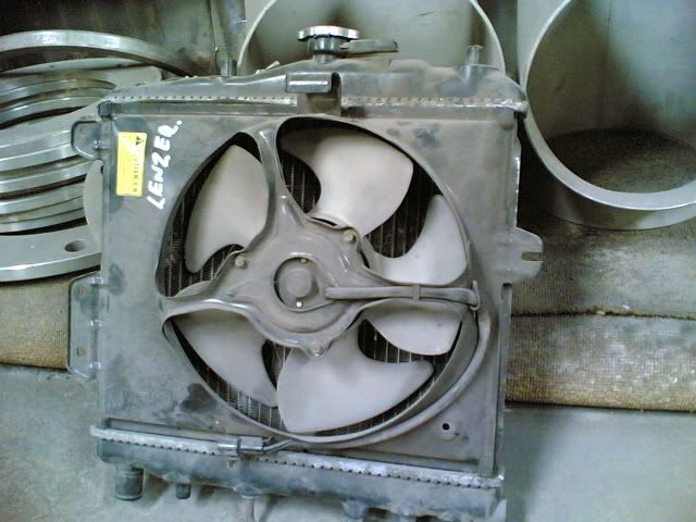

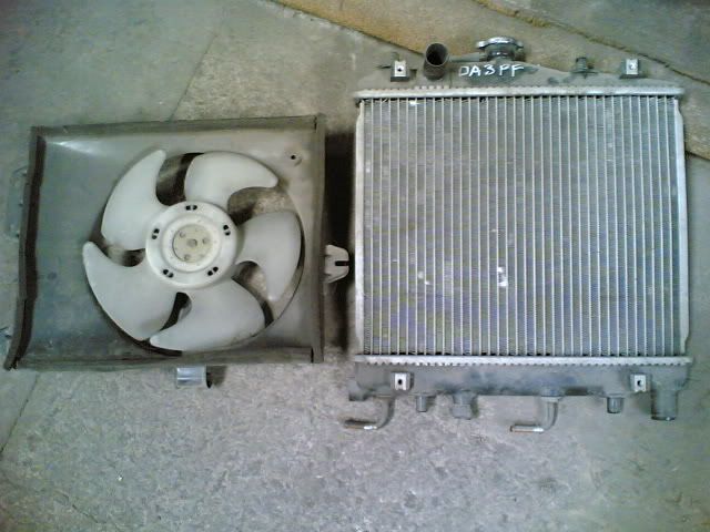

Here are a couple of pics of my new Moke radiator.
Note how the Jap thermo fan blades are designed for low noise (unlike a VK Commodore)
and the curved shroud to promote laminar flow.
This shroud is steel, but many are just plastic. Says "Lenzer" on so I guess its from a Lancer.
The radiator is an alloy Nissan unit I think. I just mixed and matched to get what I wanted.

Transitional or laminar - this thing will never fit behind a mini radiator - or would it now? (Can it be mounted externaly?)
PostPosted: Sun Oct 16, 2005 5:41 am
The alloy radiator & Lancer thermo fan (above pic) will be front mounted in the Moke
but from memory the Nissan Pulsar fan is much more compact. I suppose I will just have to go measure one :?
PostPosted: Sun Oct 16, 2005 7:02 am
Posts: 39752
Mike, you can just mount it to the inner guard where the grille bars are, make a tin shroud if you want. Many people don't bother.
You would also need to seal around the rad with a strip of rubber, like early Minis had originally. :wink:
