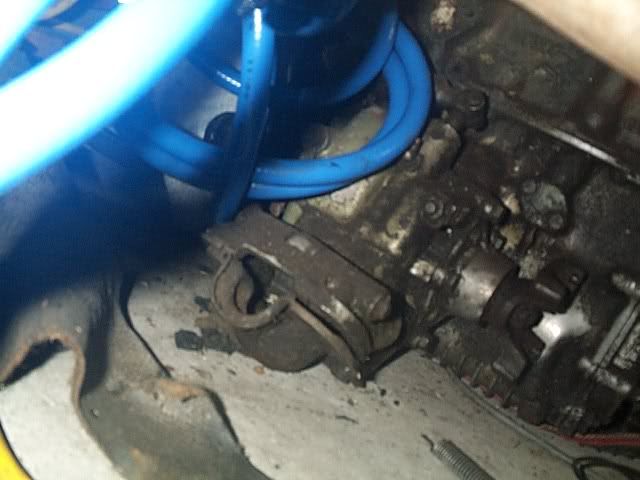

cheers Doc much appreciated.. i have a few spare boxes so should find the bits i need.. next question is a 4th shift type i have remote, rod, and pudding stick and a 4th that looks like a remote housing with a plate on the botom that has a half round opening at the rear?? whats this??

Maybe it's a Moke, some had a strange shift setup. Got pic??

PostPosted: Thu Oct 06, 2005 8:21 pm
Posts: 1285
Location: the Cold Toast QLD

PostPosted: Thu Oct 06, 2005 8:25 pm
Posts: 39752
Diff housing looks like a standard remote type, I can't really see what's under it.
But the bellcrank looks strange from that pic...

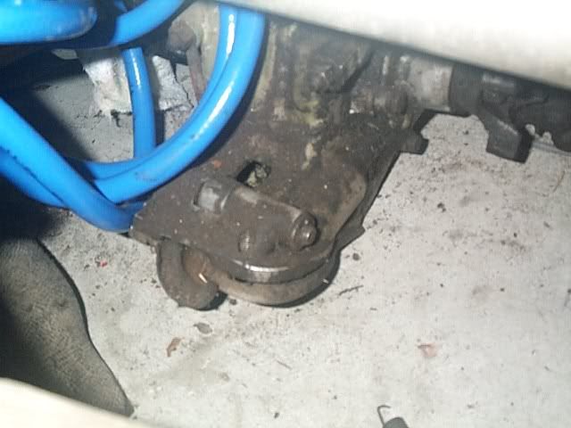

PostPosted: Thu Oct 06, 2005 8:32 pm
Posts: 1285
the hole on the top of where the remote unit attaches is usually has a tin cover rivited over it on remoteboxes... this is open and has a chunky lever end that flaps up through it.. gear stick of some sort is supposed to go up the hole at the end..
sorry best extra pic i took
PostPosted: Thu Oct 06, 2005 8:37 pm
Posts: 39752
A connection onto there thru the top slot will only give shift movement in the fore & aft direction. To move across the gate the shift shaft up thru the diff housing needs to be rotated.
:idea: Maybe it's just a remote, & that bellcrank is upside down..???
BTW many remotes never had a tin plate over the top. They added it later to stop spare parts and crap falling in. :wink:

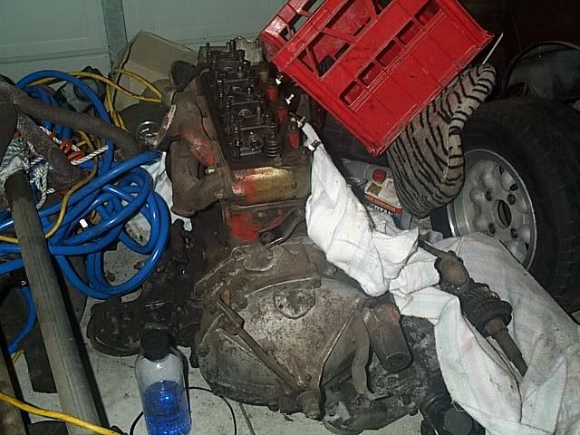

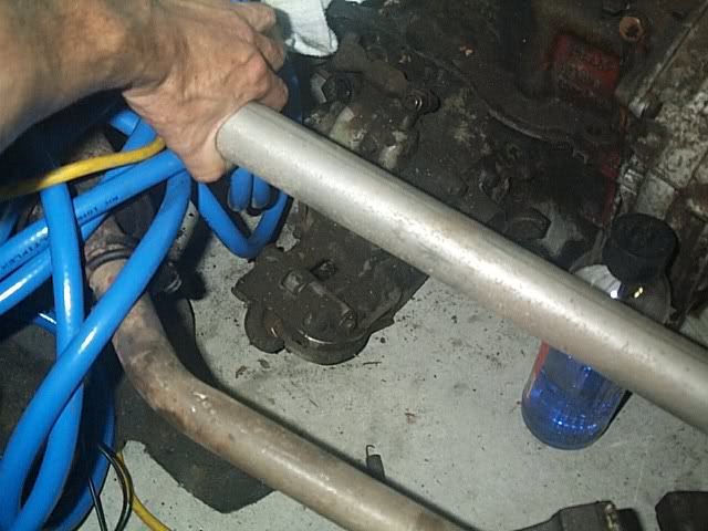

PostPosted: Thu Oct 06, 2005 8:55 pm
Posts: 1285
this was one of 5 complete motors i got from the closing mini wreckers.. i have no history on it but was told it was a good runner..motor is 998
heres an angle showing its similarity to remote type behind... and a pick looking up the hole
PostPosted: Thu Oct 06, 2005 9:33 pm
Posts: 1084
That is the 4 synchro remote magic wand set up missing the gear stick.
Steve
PostPosted: Thu Oct 06, 2005 9:40 pm
Posts: 1285
what does it come from??
PostPosted: Fri Oct 07, 2005 7:40 am
Posts: 1084
Found in early 70's Mokes and Clubman Vans, sorry don't know the years, presumably just prior to rod change boxes coming in.
Steve
