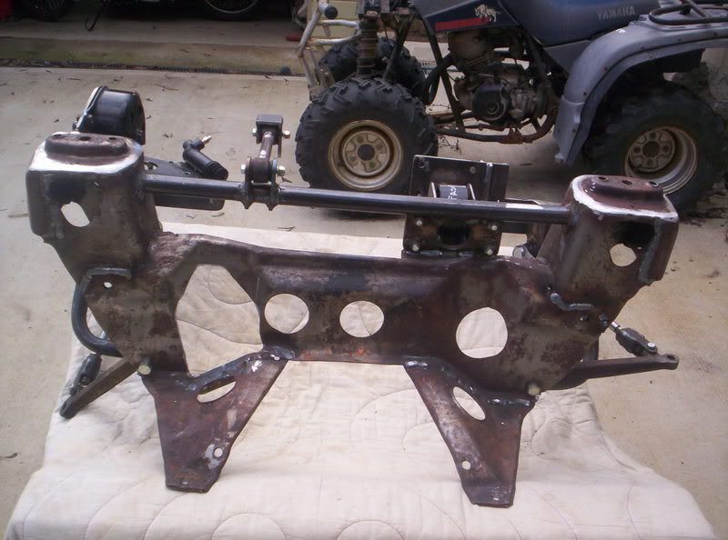

First the engine bay was stripped out & front subframe removed, the wireing harness
was a disarster so that ended up getting the big chop & thrown into the corner

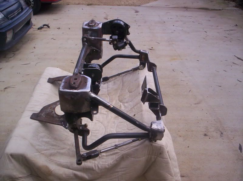

I knew basically how I was going to build the new subframe (thanks to DT) but how to
bend the tubes presented a bit of a problem. I sent some samples to a friend in Sydney
he computor bent a few sets for me Problem Solved & he still has the program.

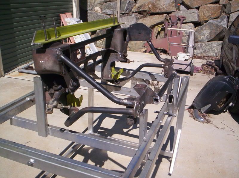

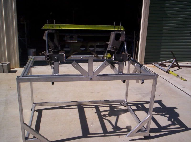

Next build a jig to hold the subframe to stop things twisting when the welding started
Here's the jig note the big yellow brace bolted to the top of the towers, this stops the towers from twisting & pulling in

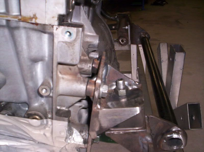

This photo shows the almost completed subframe in the jig, the yellow brackets where
the bottom suspension arms go were use to locate the engine. I had a dummy gearbox &
just put a long shaft through the diff to support the engine on these brackets

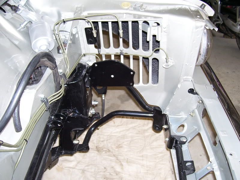

Here's the completed subframe

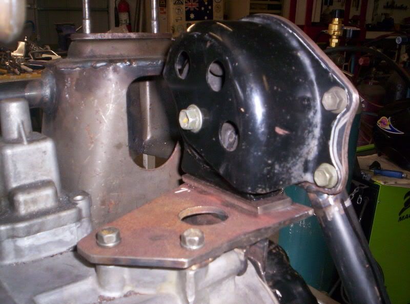

Engine mounts

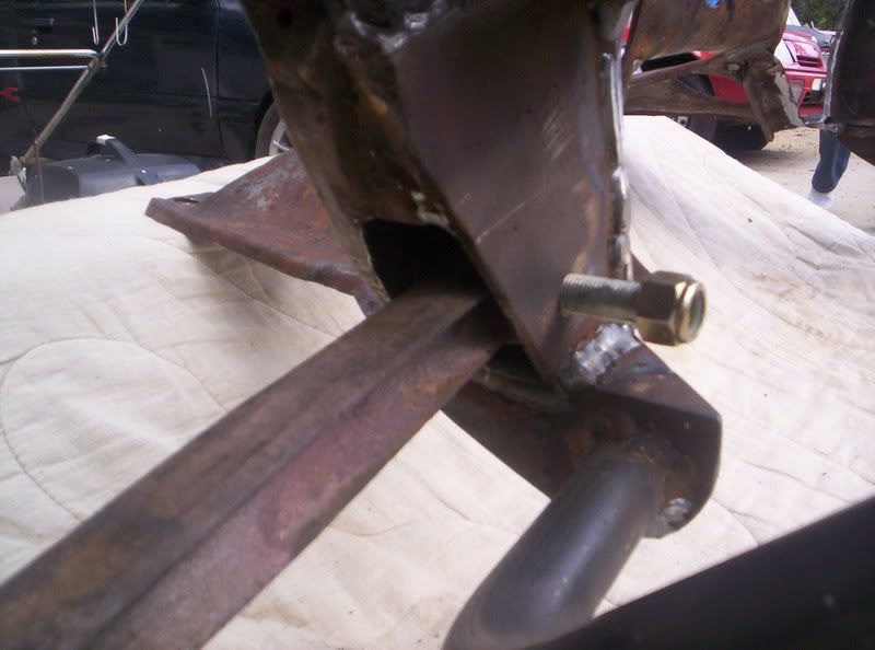

The bottom suspension arm mount is boxed in

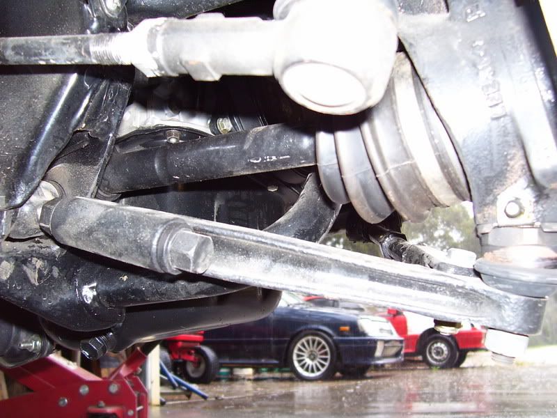

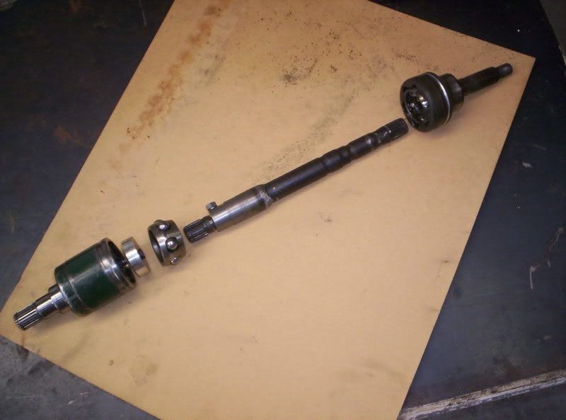

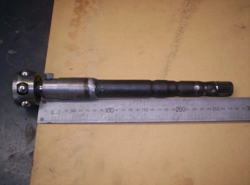

Mini pot joint driveshafts are used. This is the sliding jig I used to get the correct length
for each shaft. The shaft was cut & resplined to suit the Suzuki pot joint

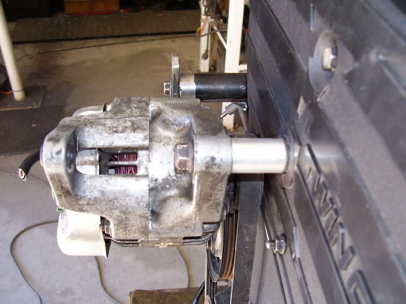

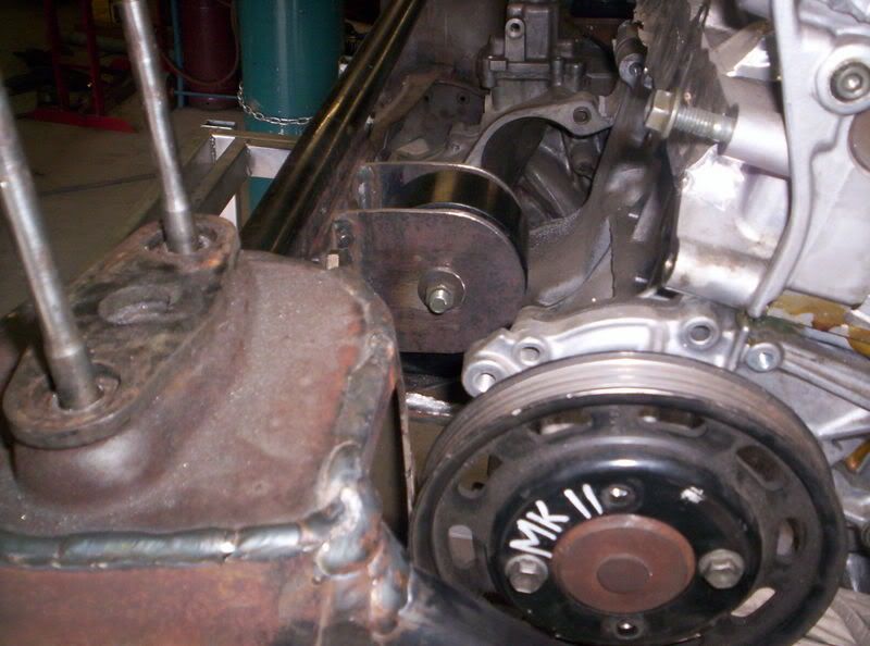

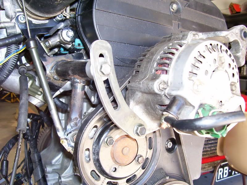

A hole is cut in the r/h inner guard to alloy the mounting of the alternator
Alternator mount was then fabricated

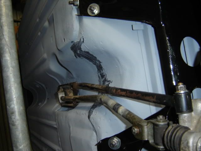

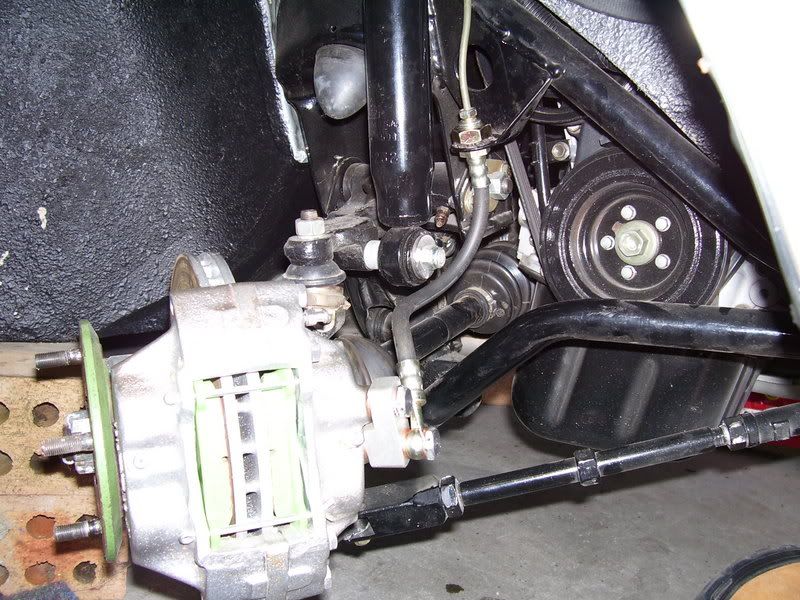

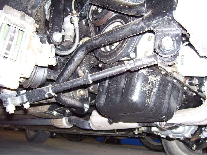

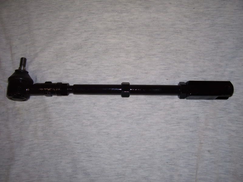

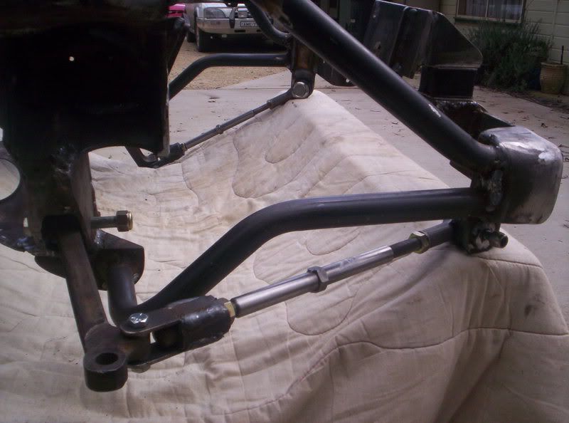

Fabricated adjustable tie bars & Mini Spares adjustable bottom suspension arms

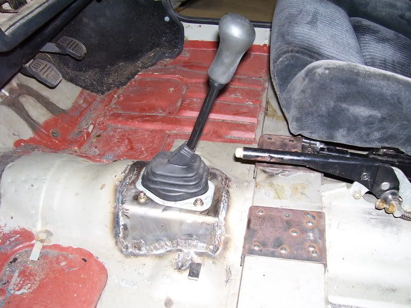

Suzuki gearshift mount & cut/shut shift rods

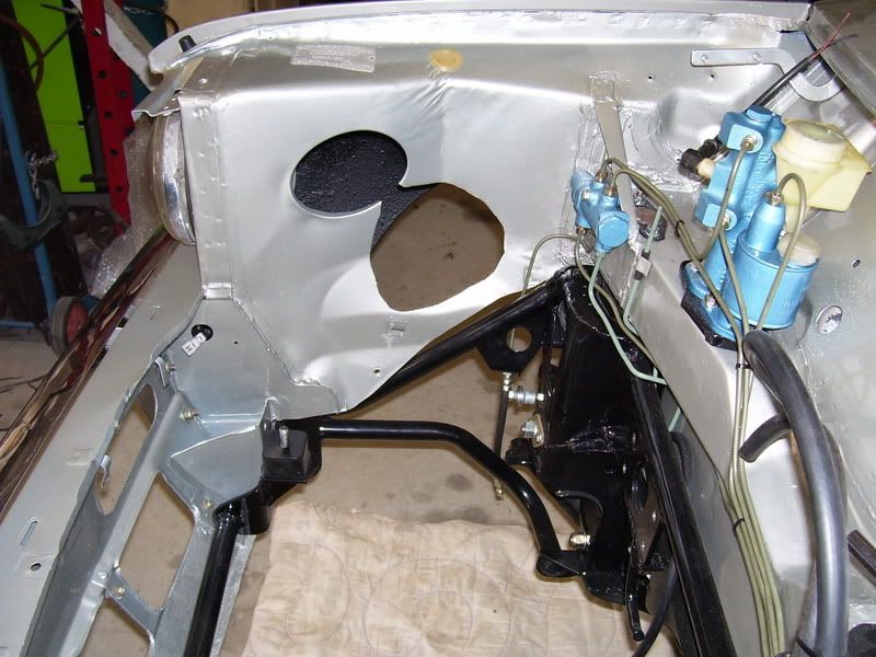

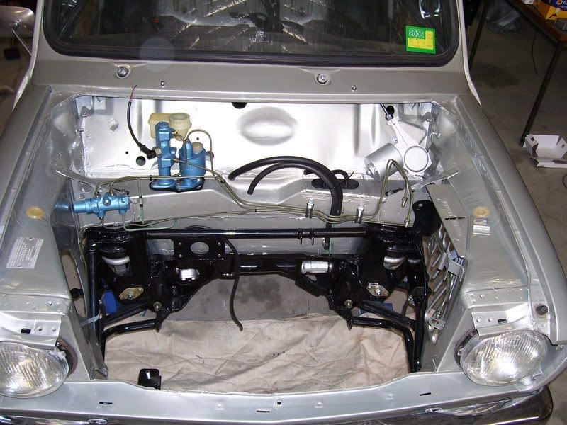

Engine bay all nicely repainted with subframe installed

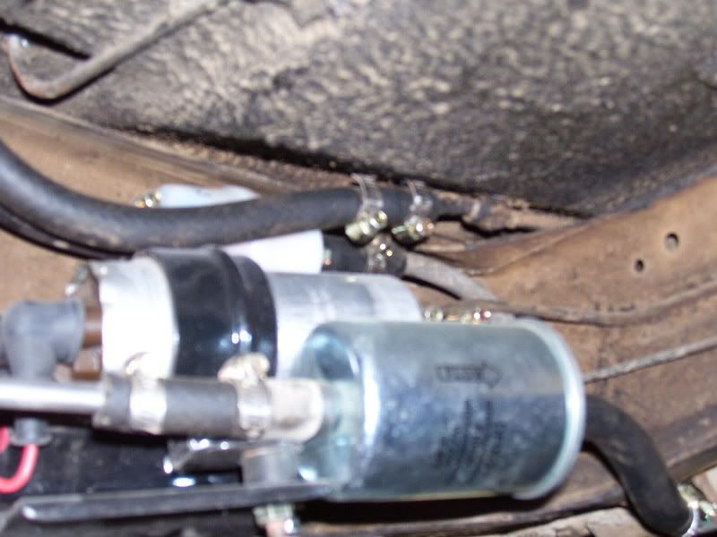

VL Commodor fuel pump & filters

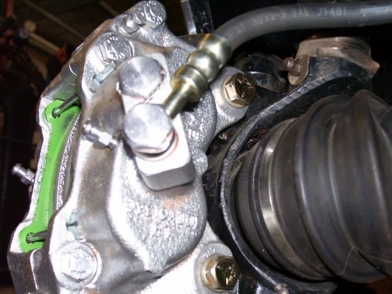

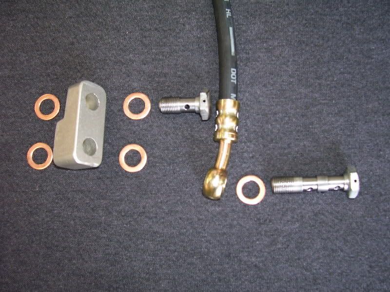

Metro turbo ventilated brakes useing a single hose. The machined up block joins the
ports in the 4 spot calliper

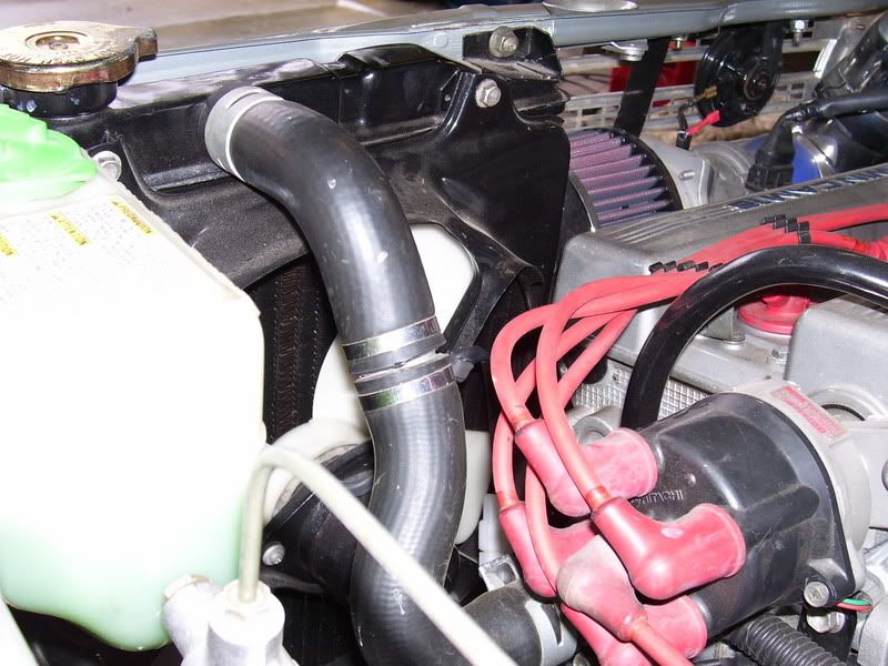

Final engine installed with SR20 throttle body & front mount AFM & K&N filter
A Diahatsu 1200 radiator fits perfectly with just a little taken out of the fan shroud
A combination of V8 Valiant & Datsun 1200 make up the radiator hoses

loving that subframe - what's the full story with the computer tube bending??

The guy who bent the tubes up manufactures motorcycle stands & the machine that bends them uses a computor generated drawing/program to make the compound bends at the correct distance & angle. Although the bends are'nt "mandrel bent" you would think they were they are that good

Q: Is there sufficient clearance between the alternator and the wheel on full lock and full compression (bump)??
Yes mate, heaps, comes no where near it

I'm sure you have this under control, but it made me have a double-take. the adjustable tie bars you've made using a steering tie-rod end - tie rod ends aren't made for those kind of forces, and do wear out. Just keep an eye on them for wear, as using them for caster control does put a lot of force on them....

The forces on the tie rod ends are in the same plane, weather they be used on the
steering rack or on the tie bars
DT has been useing the same sutup for about 6 years still with the original tie rod ends
& they are as good as new
Blue
Keep shiny side up

okey dokey, as long as it's in hand :)
