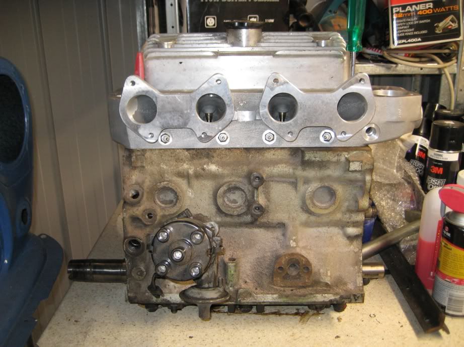

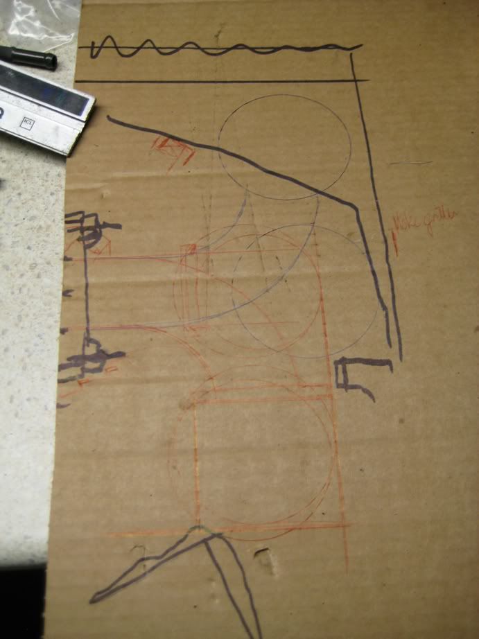

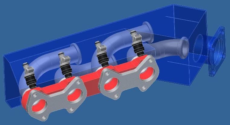

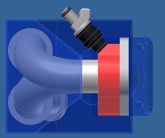

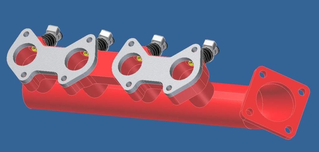

Ok I have some progress pics. I have had the set-up on the bench to measure. I don't actually have a car with the engine in the bay to measure off so it has been a bit hit & miss.
That got me sketching. Here is a comparison between Moke and Roundy engine bays. The head's mounting face is the left edge of the carboard. To the right is the grille. The black on the left is the plenum mounting flange.
Moke is about 20mm longer and much higher. Some sketches of plenum location options blue for Moke and red for roundy. I think Clubby engine bays are 80mm longer than roundy and as high as a Mokes so they are easy peasy.

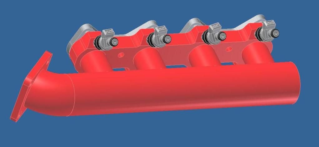

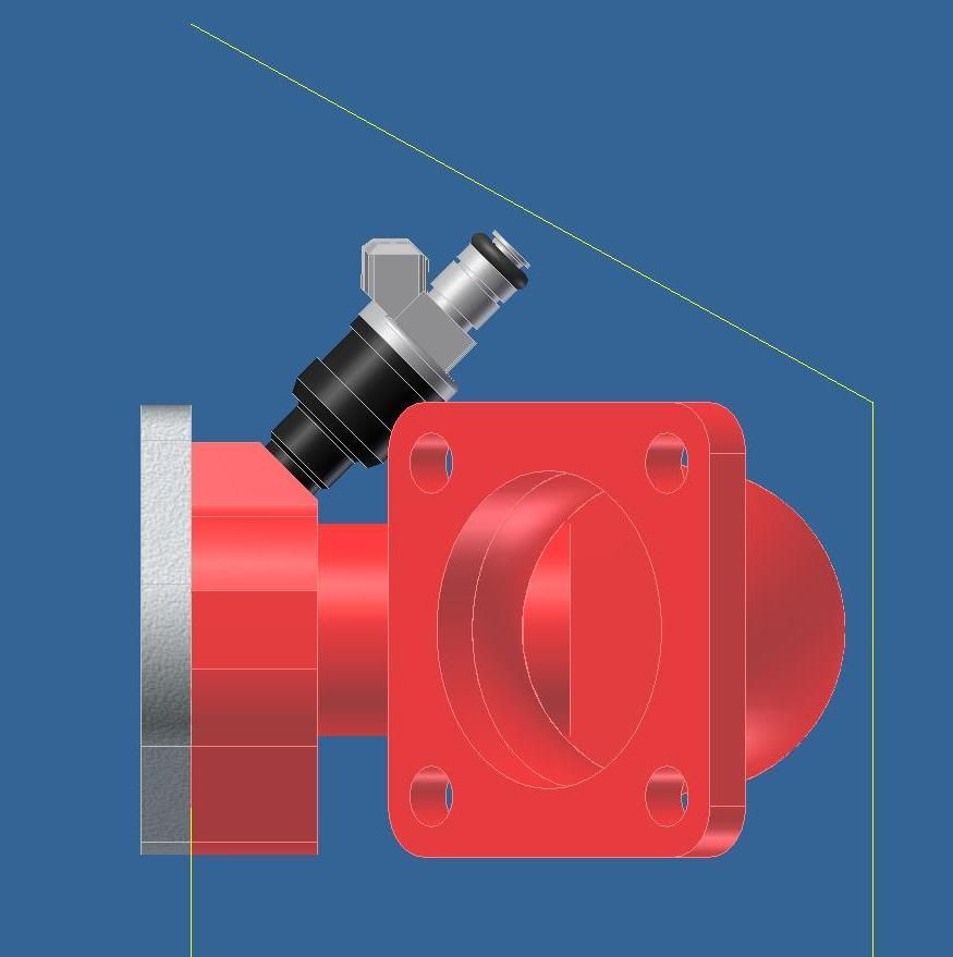

Then I knocked up the simplest one in Inventor. It has been years since I drove Inventor so it has been clumsy progress. Of course this design doesn't yet have the radiussed inlets to the runners but it is just to show what may fit. It isn't pretty with very short runners and small diameter plenum. Fine for a forced induction set-up though :wink:
To get the fuel rail to clear the bonnet (maybe) I have pushed the injectors as close to the head as possible. That means the red part has to mate to the head using the bottom Weber mount studs and two new studs between the inlets. Throttle body flange is just a mock-up. It doesn't represent the actual throttle.
This first image shows the approximate bonnet and bonnet slam panel positions. Very ugly around the fuel rail area.
I'll try to have a go at a Moke high rider plenum tomorrow and maybe a roundy long-runner-low-plenum some time soon.

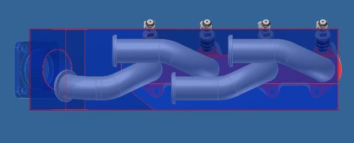

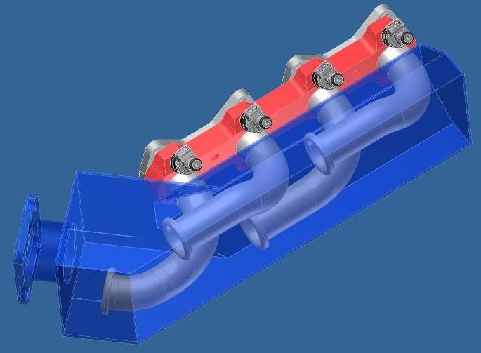

I've had some time to do more sketching today. Here is a layout of a much longer set of inlet runners. The plenum box is a bit rough around where it lines up to the throttle body but I couldn't be bothered making it pretty. It is all about whether the runners fit in and if the spark plugs and mounting nuts can be accessed. It looks ok but the top of the plenum may clash with the bonnet catch mechanism. Also, it may hit the headlight bucket of a Moke. More work to do.
These runners would be about the same length as the total of a Weber and trumpets/socks inside a clubby.
Next is to do a similar arrangement but with all pipes pointing down and across. It will need a plenum with a goose-neck to get the throttle body back up.
M

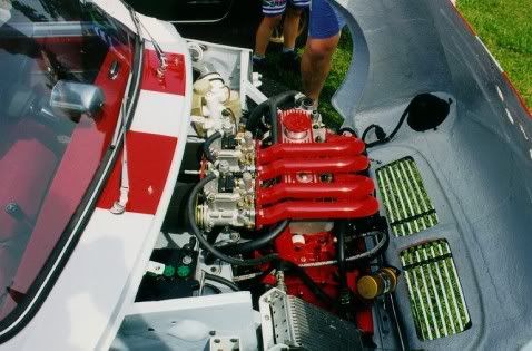

What about something like this? (its an elder 8 port, but perhaps the basic idea could work?)
More images and info here about it:http://www.starchak.ca/8port/efi.htm
I'm trying to work out what to use on my 7 port too. Tossing up between a set of gsxr quad throttles off ebay or something like the above.
Andrew

Thanks for that. There are a few things I'll have that are different. I would like to keep the stock alternator position/size which would push #1 runner to the gearbox end more. I'd like to keep the distributor as my plan is to make a hybrid dizzy to use the Mazda CAS from an MX5. (this is part of my cheapo EFI plan that has me using an MX5 programmable ECU and all the engine bits from an MX5) That really stuffs up the height. That head has the inlet ports at the same height as the ports on a 5-port. The Pierce head has the inlets raised up and out towards the grille to provide the DCOE flange pattern. That make the fuel rail higher towards the bonnet.
I will have a crack at something like that though.

Can you put the injectors under the inlet tube to keep the fuel rail much lower?
You'd have to angle then slightly away from the spak plugs though.
PostPosted: Mon Sep 19, 2011 3:15 pm
Posts: 2495
Location: Vegus, Brisvegus
I looked at that. The issues I had were that the injectors had to be at strange angles to avoid the plugs and leads and the spray pattern would all be on the roof of the port. Top mounting the injectors let's them point down the ports and allows a straight fuel rail. I found from my last attempt that the rail was as hard to make as the manifold. I am actually hoping to use MX5 fuel rail as it has 4 by 90mm injector spacing and the pierce head has 90, 93, 90. Another part I can get from the wrecker and not have to make.
