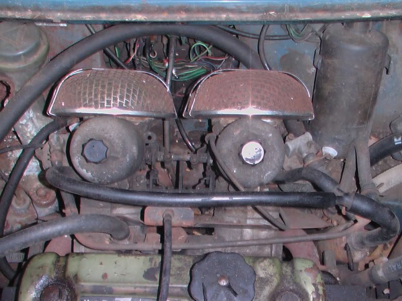

Here is a photo from Doug's car. Notice the plastic Y piece sits over to one side.

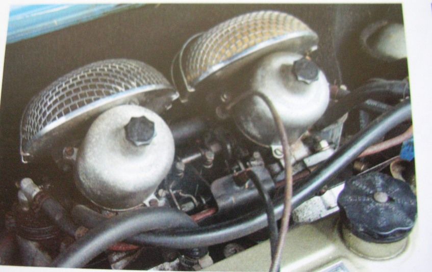

And another one.

Excuse all the dirt, grease and grime in my engine bay (pic above). That's how it looked after 20 years sitting doing nothing.

looks like a couple of restorers weren't sure which way to put the Y...
