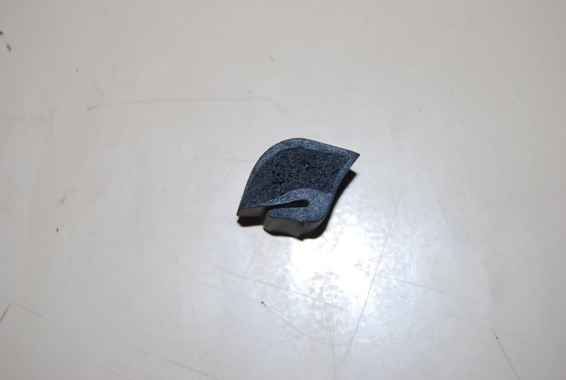

Thanks for the replies so far.
Andrew's photo post is very useful, and makes me think that I'll need to chuck out my current (new) seal. Bugger! I can't remember where it came from now, as I've had it a while.
Buyer beware I suppose.
Matt
 Post subject: Boot lid seal
PostPosted: Sun Jan 18, 2009 7:25 pm
Posts: 389
Location: Flynn, ACT
Here is mine - worse than the other inferior one shown in Andrew's photo.
No wonder it's not working!
Matt
PostPosted: Sun Jan 18, 2009 7:45 pm
Posts: 3166
yes the Minisport rubber is great. the others deform the boot or are impossible to close. :(
Matt
I would try This, before you throw it, I think it may do the Job
