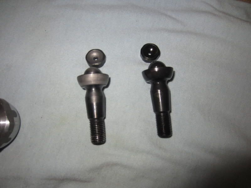

also, the clutch arm often gets intentionally bent (you may have one) by a common workshop practice and oxy torch because the slave cylinder piston needs to move back down the cylinder bore because the flywheel goes back on the crank taper a little more each time it comes off....assuming the same flywheel is being used.
I used an old ball joint seat (the same as those pictured at the top of the image below) between the push-rod and the plunger of my slave cylinder to pack it out a bit more. They seat nice an tight (I think I had to sand the outer diameter down a tiny bit). This means no arm bending required. I think you can also get lengthened push-rods too.

PostPosted: Wed Feb 25, 2015 3:51 pm
I have not seen that before! Something new every day :)
