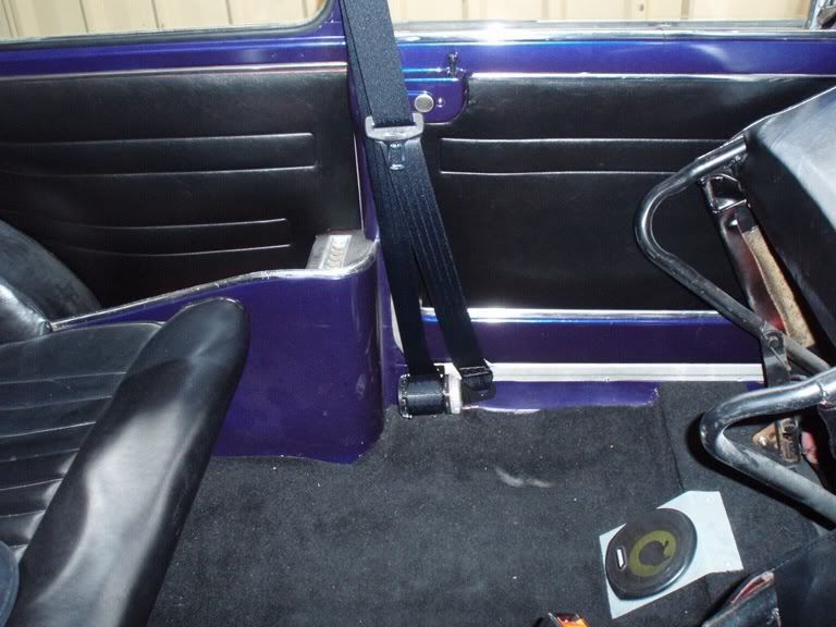

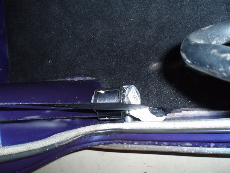

Got some pics for scrutineering, enjoy
To try and explain my reasoning "I've did a drawing thats heaps good" :oops: Just trying to show that the seatbelt brackets act as the reinforcement.^^^
The 2nd shot shows it the best that the anchor point is as close to the B pillar as possible
This one is just showing how I'm protecting the belt from the sharp edge of the ash-tray. note colour coded pegs to make it blend in :wink: almost professional wouldn't you say :lol: .
I know that a "pulley" dose increase the forces but I doubt that it can double them, me and my regular passengers weigh in between 45-65kg so if the std top mount can't support those forces even if their doubled then there's something wrong with the structure of the car in the first place.
