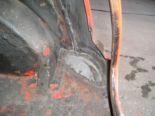

Posts: 1461
Cut the rusted area out and weld a new one in..
Here are some pics of what i mean
The first is the boot, where the spare is..
This is in the boot rear driver side corner

Nice welding there, Gordo.. 8)
When I did our Clubbie, the whole circular spare wheel well was history. An old XT computer gave its 1.0mm cabinet for the cause. :lol:

I wish i could take credit for it....
The only thing that comes close to welding that i have done is silver soldering for copper pipe fittings with oxy and acetelene. I will learn how to weld...ONE DAY
