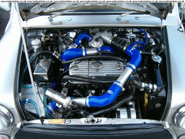

http://www.turbo-mini.com/ also a good site here is a pic of the mirage motosport manifold u get that and the dump pipe for 350pounds :shock:

awdmoke wrote:
8) Minimal lag with it so close to the ports
That avonbar firewall box will replace your heater - in more ways than one :)
heater :? what heater BHAHAHA. FARK THAT.. undue weight.. :lol:

this is the Avonbar racing weber box and bulk head turbo mod box.
year seen them Ben. lots of money.. lol there kits are no body mod kits to.

now thats more like it Cody
PostPosted: Tue Sep 06, 2005 6:25 pm
Posts: 1556
Location: Central Coast, NSW
Man, all i can say is that your pockets are a LOT deeper than mine.....
The Mirage setup looks like any competant engineering shop could knock it up in a few hours (= about $400)
the Plenum is just a modified standard one (mine is simarly modified and cost about $40 to mod)
Knock yourself out, its your car, but hey, I'd rather spend money on getting it fast, rather than paying postage. . . . . . .
Personally, mine is mounted over the clutch housing and the extra length of the exhaust helps settle the "pulsing" for the A-Series 3-port exhaust setup, yea, i loose some space, and the ability to have a booster, but hey... who really needs one !
I too played with the idea of an intercooler in the drivers wheel arch, but the thickness you'd need to overcome the temperature change needed (not a lot of airflow in a wheelarch.. remember ?) was too thick for my wheels to turn left. . . . at all . . . that was a stock S-13 intercooler.....
I'm playing with water injection at the moment, just getting the jetting right, i might have it hooked up for Saturday, but who knows....
Biggest hassle for my setup is getting the charge from the turbo to the plenum.... need big pipes, but no room for big pipes !
Hmmmmmmmm
J

what about making a custom plenium like this im thinking of the doing the same (slthough i already have a standard metro turbo one)

Yeah I know there a standard chamber. you have to send them in to get done. I will do the mods myself. but for looks sake thats what the pics a for.
The only things I will get from Avonbar are...
Dump valve, T3 Billet Alloy Actuator and maybe Ignition Management system.. still looking around.
I do not see the point in going half assed about it. might aswell take 6 months more and do it right at the start

The end result I will be looking for. :D

faaaaark thats nice
PostPosted: Wed Sep 07, 2005 12:51 pm
Very nice, but very busy
if you dropped your 1/2" spanner in there, it wouldn't come out the bottom!
they never come out anyways. lol :lol:

I'd hate to do the Bottom Radiator Hose on that one...you maybe able to get a couple of fingers in and thats all

No inner guards on evil remember. I am sure a bit of thinking will make it easy.. and its not that much more then a normal mini anyways. take FARK all to take the pipes off.
