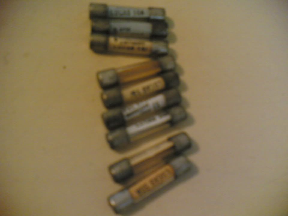

So this lot must be really rare?
There are heaps of original Lucas fuses lurking under the dash of old Jags,
with the paper in them to make the smoke for the wires :wink:
PS I don't have a flash on my camera phone :roll:
