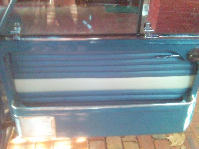

here's some pics of one i did today
first off here's the "boot stitch" that joins the two tone vinyl together
here you can see it a bit closer
its just about ready to stitch up. first off there is a layer of calico, then foam and then the vinyl
this is what its like when its been stitched. after this part the door trim gets stuck to the aeroplane sound deadening
and then the fitting happens, its alot easier to fit then normal door card because its actually flexible.
diff angle. so what do you think?
