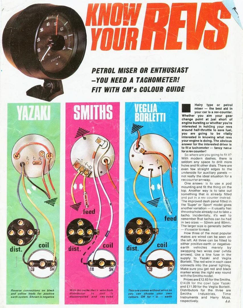

found this....
The other wire on the -ve side of coil should that be cut and wired like the above image?
so cut the wire from the -ve of coil and make new wire from the bullet connector to the distributor?
Isnt that the same thing???
