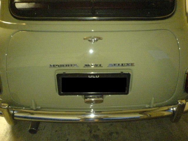

PostPosted: Mon Nov 06, 2006 6:50 pm
Give Ash some flowers Nick .
Posts: 10149
Hey >Rude< at least you will now know that 1 other person has a morris mini deluxe! Now for some pics!
I CAN'T GET MY PICS TO LOAD - CAN SOMEONE TELL ME HOW PLEASE!

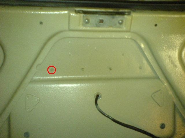

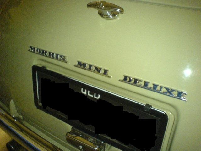

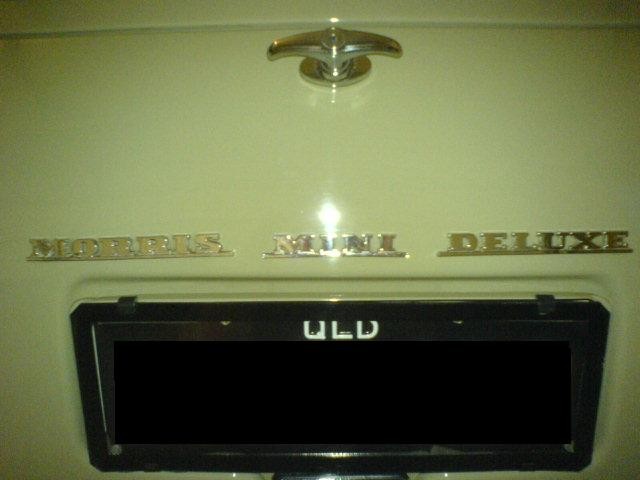

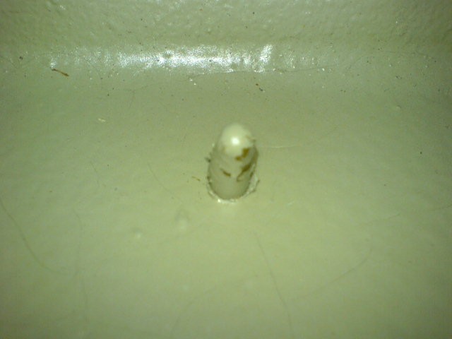

There are actually two more little plastic retainers that you can't see that are underneath the metal.
Measurements:- From the top of the light underneath the number plate to the centre of the words is 7 & 3/8". The spacing between each word (from the closest point which is the line underneath) is 7/8". Just say if you want some more detail. My car was originally a Morris Mini Deluxe and this is still the original bootlid.

PostPosted: Mon Nov 06, 2006 7:09 pm
Posts: 4031
I had to do some good stuff to put my cooper s badges on. Last owner had put Morris Mini 1100 just a half inch below the boot handle and filled the original hole. DUMB!.... I put min in realtion to where the original hole were (remains of pins could be seen on the inside on the bootlid.) even tho won't be much help to you here it is. BTW the swing down number plate thing was to make driving with baggages stacked up on the back legal. Although I would doubt that is it nowadays anyways.,.. :lol:

Thanx 1018cc for the email, the pics are very helpful especially wit the measurements
cheers
