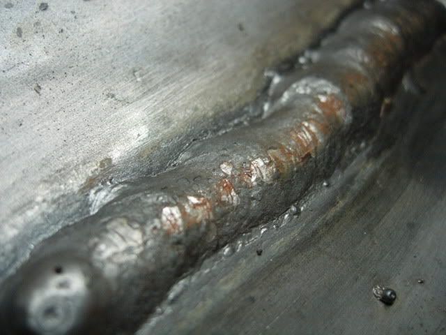

Still haven't perfected it but this a close up shot of a lap weld where one piece of metal has been overlaped on another and welded at the join. Think of this being when you weld in a floor and the new section overlaps the old part. It's not a 'butt' weld. You can see where the zinc coating on the sheets has bubbled up onto the weld. Don't have any shots of a weld on mild steel, although I am going to weld up a rotisserie over the next few weeks - so I can show you then
