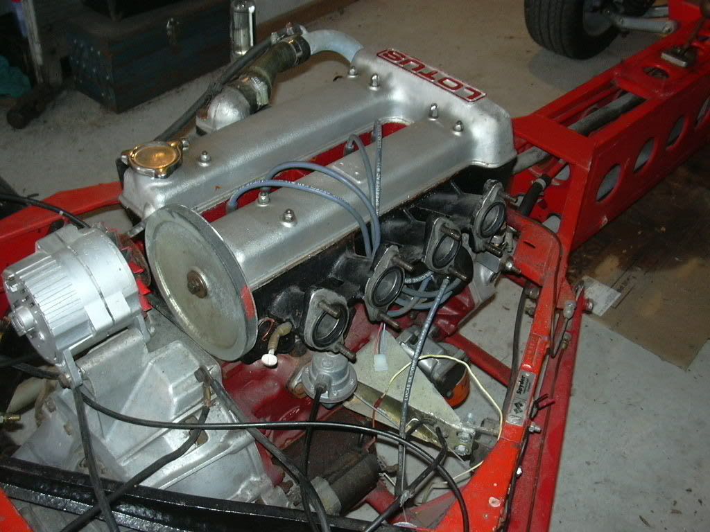

Hey MiniMan what kind of engine is that in the Moke? Doesn't look like a Lotus TC?
Pete
PostPosted: Wed Nov 14, 2007 3:01 pm
Posts: 3477
Location: Queanbeyan
I got the lotus head but it is attached to one of my Lotus's

any one ever heard of some sort of s datsun head going on an a series?
some old codga was rantin about it the other day and how it "makes it
go faster" lol
Mearcat wrote:
PostPosted: Wed Nov 14, 2007 10:21 pm
Posts: 39757
go faster" lol
It's an urban myth that the A12 Datsun head fits an A series.
The pushrods and camshaft are all on the other side, for starters.
I'd really love to know how this one began... but it's been debunked many times here. :lol:

all so just wondering... what do you do with the old cam in the mini motor when you put a twin cam hed on a mini block? im not that mechanicaly minded so correct me if i said something stupid just than lol
Mearcat wrote:
PostPosted: Wed Nov 14, 2007 10:32 pm
Give Ash some flowers Nick .
Posts: 10149
For mad matt's twinky conversion you just leave it in the engine --> the cam is needed to drive the oil pump.
PostPosted: Wed Nov 14, 2007 10:33 pm
You leave it in the motor to drive the oil pump and the dizzy.
PostPosted: Wed Nov 14, 2007 10:34 pm
Posts: 751
Location: Cootamundra, NSW
ahh yes i see as it has a lobe am i right geez you would loose a bit
of power through the drive chain with a twin cam head like this :?
Mearcat wrote:
PostPosted: Wed Nov 14, 2007 10:40 pm
Everything that is driven from the crank will cost power. The cam, double valve springs, water pump, etc. all take power to run. But just try to run without them! :lol:
So the chain drive to a twin-cam head will lose a bit more power but that is nothing compared to the gain that you are getting from the twin cam head.
