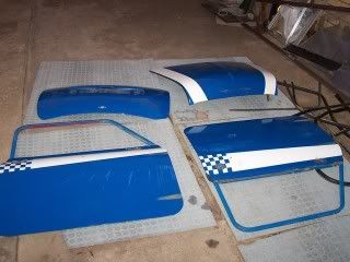

No one mentioned how much swearing was involved in getting the hood lining out, but it is finally out :D Also got the doors completely striped.
Progress pics

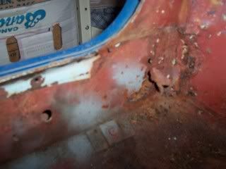

And one of the reasons the car is getting striped
Lets hope I don't find too much more :oops:

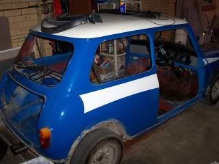

Caponix came around yesterday and helped me pull the engine out, the hardest part was separating the ball joints. I made up one of those engine lifting brackets from the "how to's" and it was really easy :D
All that's left is the wiring and a few little bits and bops.
