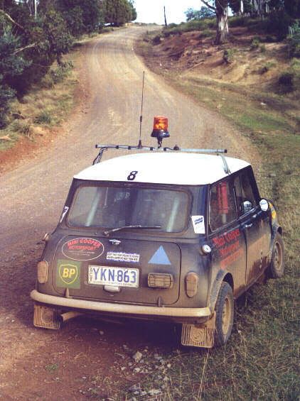

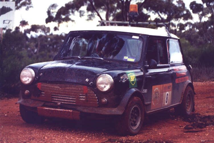

Here's some photo's of when we did the Kidney Foundation's Circle Australia Rally Back in '96. May as well put them up for all, Hope they are of some help.
16,000km's in 26 days! Boy you value sleep after that! :o

Tasy somewere. After the front right Tie bar nut came off :o
We put the perspex sheild on the grill when the Weber kept Icing up - We weren't running a thermostat... don't ask :shock: It was also good for keeping the Dizzy dry. The cut out is for the oil cooler.
Somewere? after we cleaned it...

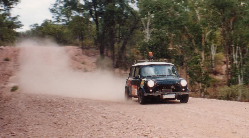

Somewere in W.A.
:D
AKA - "Minimal Effort" opening her up in QLD:
Conclusion:
Build the car more for endurance than speed on an event like this. Mini's are pretty strong as standard, but there are plenty of small mods which are definitely worth doing (most of which have been mentioned). Hope some of the pictures are of help or enthuse you, I don't seem to have any shots of the detailed mods we did.
Please ask as many questions as you like.
