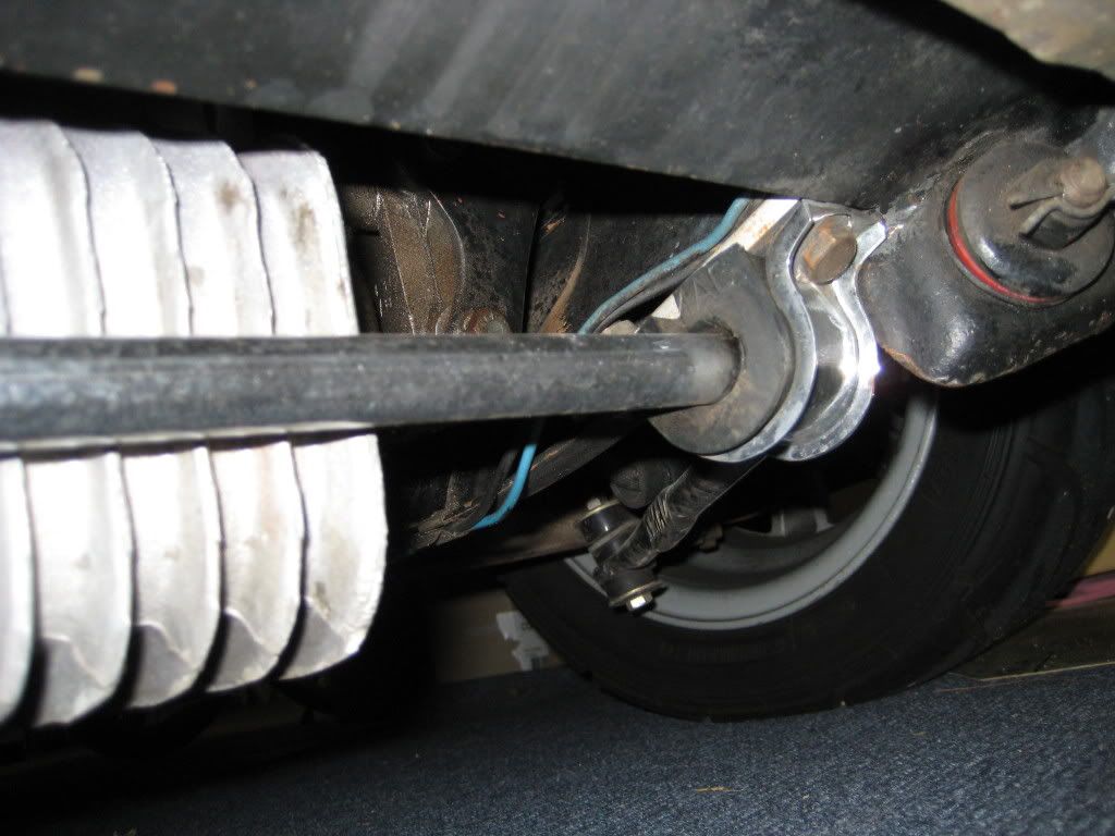

Matt68 wrote:
So anyone with pics of how they connect? To me it looks like they clamp to the lower control arms out near the ball joints, with the rod brackets near the front of the subframe on the forward facing bit that joins the cross -piece...
I'II post some photos of mine on the weekend. This is exactly how mine is mounted. I run front and rear bars with an LSD and slicks.

Rookiepilot wrote:
Thanks!! That would be great!
Matt

Here you go,this is my K Mac set up-hope it helps you :)
THank you!
So it does fit pretty much as i thought (not really many places to bolt it)!
Excellent!!
Matt
