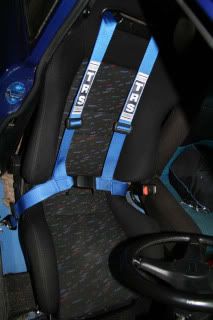

I have a set of Clippan 4 point harnesses. They have a standard seat belt style clip at the front. The packaging clearly stated that these belts are ADR compliant.
They come in 2 types, 4 mount points aor three with the rear either two or one.
I expect they would be legal if:
(1) all the mounting points are either original or engineered to be the correct type and position. In qld this can be by a blue plate.
(2) they are fitted to a 2 seater that is of correct age to not need retractors.
I have them in my MX-5 for track day use only so I haven't bothered with getting them approved. I still use the stock belts on the road.

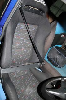

Harnesses are also hard to buy and also harder to fit correctly. Most harnesses are mounted incorrectly and can cause injury in an accident.
The shoulder straps should be mounted at 90° to the spine (+ or - 5°) but you still see Minis with the shoulder straps mounted to the floor which will compress the spine in a frontal crash.

I have a VELO seat and it sits fairly low and the shoulder strap went over the corner of the seat as normal. The lap belt from the pillar side is threaded through the hole in the side of the seat, and the otherside the buckle poked through the other hole. It didn't have the original buckle that is fixed like the clubman style one it was a klippan one that was on a flexible cable. It all fitted properly and didn't allow you to move around.
