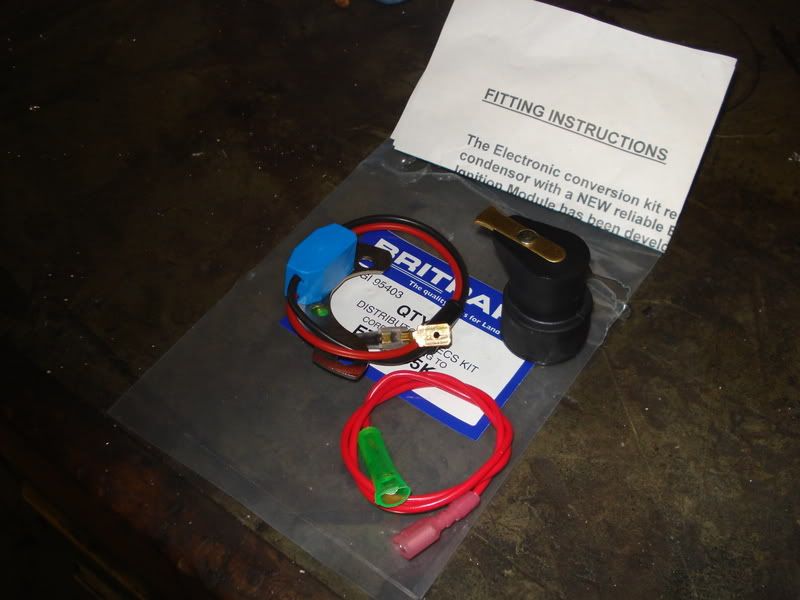

Took the plunge and ordered the Britpart conversion kit for the 45D and had a friend pick them up and post them to me. Ended up quite cheap, not a lot of difference between this and the cost of a new condensor and points. The best part is that they fit either the long shaft or short shaft 45D distributors which now means I have a spare distributor. Both have been tested and work great. Downside is they have since put their prices up from UK 6.95 to UK 8.10.

Matt, the ones I got are the 'blue' variety also and there is now a newer 'red' variety available but at twice the price. Hope mine stays reliable.
sports850, as Matt says there is also one available for the 25D side entry, UK 15.10 plus UK 7.00 postage is the best price I've found. Works out around $50 delivered here. It now means that there are kits available for all the distributor types ( 25D, 29D and 45D ) used in Australian produced minis for those who wish to keep their cars as original as possible.
1964 998 Cooper , 1968 Morris 1100

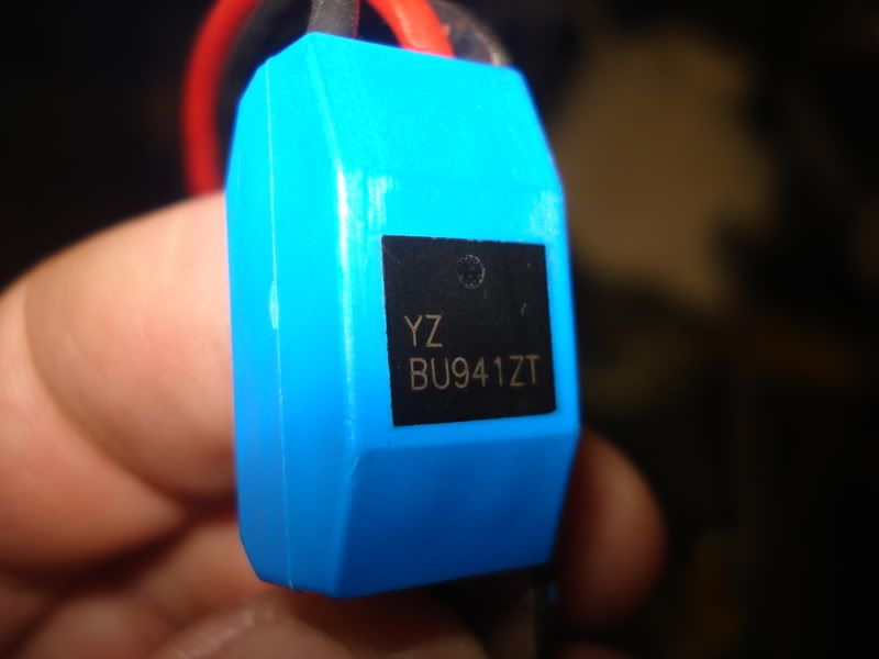

I picked up one of these kits last week. They mailed it on Friday and I got it today (Tuesday) :shock: Not bad....
The transistor is exposed, but I would prefer some sort of a heatsink to drag away some heat. Overall it isn't a bad little package. The transistor data is shown and comes up as being capable of switching 15 amps according to the data sheet. So it would be alright (on paper anyway) to be used with a 1 ohm (or even slightly less) coil.
http://www.datasheetcatalog.org/datashe ... Xyywus.pdf
The hall effect magnets can be seen around the bottom of the rotor button here.
PostPosted: Fri Mar 06, 2009 3:55 pm
Warning! Pointy headed speak below
I've been making some calculations based on the manufacturers datasheet. http://www.datasheetcatalog.org/datashe ... Xyywus.pdf
The maximum temperature that the transistor as photographed above is capable of operating at is 175 degrees. From this data sheet, the component manufacturer claims that the junction-case temperature that is generated is 2.5 degrees/Watt. This is Using a hypothetical coil of 3.0 ohms, this coil will consume 4 amperes at 100 percent duty cycle. So 4 amperes x 12 Volts is 48 watts, and 48 Watts x 2.7C/W is 129.6 degrees Celsius (lets call it 130 for fun).
Add this temperature to the ambient temperature in the distributor (approx 80 degrees, ie. block temperature) and you have an transistor operating temperature of a fraction under 200 degrees. This makes for a fairly stressed transistor and will explain the occasional failure. I can see why it is not a good idea to leave the ignition on with this going on. When the engine is running the coil is only "on" for about 50 percent of the time, so this reduces the current by the same amount thus reducing the running temperature to 145 degrees including the ambient temperature.
Not to bore anyone, but with these figures, don't leave this sucker on without the engine running, and despite my thoughts in the post above, don't use an electronic (or resistor rated) coil using this module.It is running above it's rated temperature. These figures won't destroy the transistor outright. But it will reduce its lifespan dramatically. My thoughts would be to purchase (from Jaycar) or create a heatsink and bind this onto the outward surface of the transistor using heatsink compound. This will reduce the temperature by 1.7 degrees/watt, thus the unit will run at a much reduced temperature of around 100 to 110 degrees running and 120 to 130 degrees with the ignition on but not running.... A much better option.
