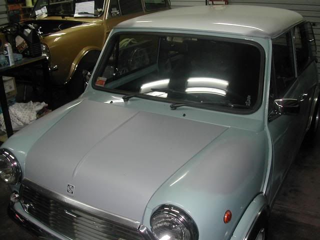

No, I they are definitely a set of Inno winodws I bought from the UK. The guy had a couple of Inno minis he was breaking. I wanted the opening 1/4 lights in teh Elf but the Aus doors won't fit my mk3 shell. So I bought Inno windows.
Mine look exactly like Min196's picture.
The Inno 1/4 light glass is different to the Aus 1/4 light glass, but the rubber seal is identical.

so ur saying if i go to karcraft and ask for "Oz quarterlights rubbers" they will fitt straight onto my windows????
PostPosted: Wed Dec 03, 2008 6:42 pm
Joined: Sat Nov 11, 2006 5:27 pm
Posts: 111
Location: Auckland, NZ
Yes I am. The L- shaped rubber that goes around the aussie 1/4 light is the same as goes around the Inno 1/4 light

PostPosted: Wed Dec 03, 2008 6:50 pm
seal, quartervent LH, HYA2747 $62.34
seal, quartervent RH, HYA2746 $62.34
seal, quartervent vertical LH, HYA2735 $14.84
seal, quartervent vertical RH, HYA2734 $14.84
The verticals don't come with rivets, I used short blind pop rivets instead.

PostPosted: Wed Dec 03, 2008 6:55 pm
Prices added above.
1st one took us about 1 hr, the 2nd one 20 mins.

MGB weatherstrip rubbers (shortened) fit best in an Oz door's clips, not sure about Inno ones.
Aftermarket Oz ones are thicker. :x
