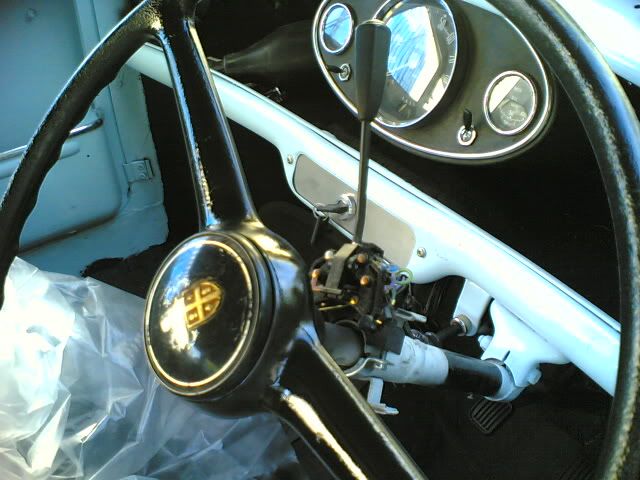

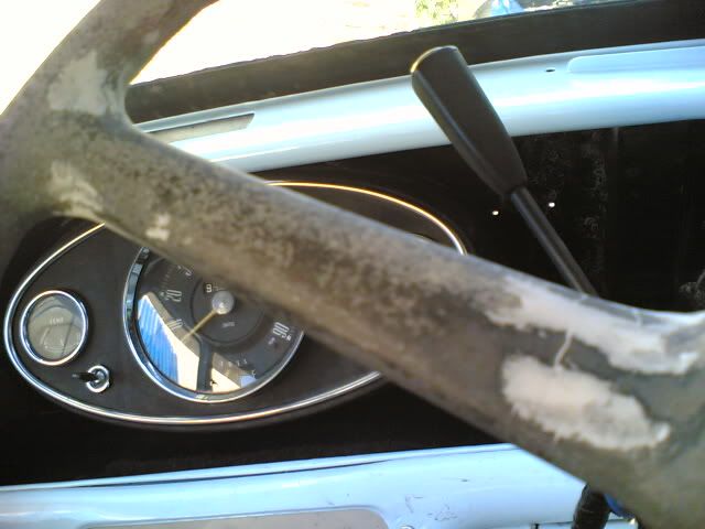

PostPosted: Thu Mar 19, 2009 2:20 pm
Posts: 2639
Thanks for the comments. I don't mind criticism either. I actually found it very difficult to get ANY professional advice on the restoration of this wheel. I drove to at least 6 or 7 panel repair and paint shops and three suppliers of automotive paint. Most of these EXPERTS either couldn't be bothered looking at it or didn't know what sort of paint or filler to use because they had never even seen a stering wheel made of a resin like substance. I imagine as time goes on there will be fewer and fewer people in these trades who will be able to help us at all with these sort of projects. On that note I try and make a point of supporting local mini people whenever possible because if we don't they will pack up. So, that led me to seeking the advice of fellow ausminiers and one in Queensland who I telephoned suggested using araldite as a filler rather than bog as it is a very similar compound to the original wheel and was reletively easy to mix, use, sand and paint. Time will tell I guess. The pictures probably don't do the wheel full justice as I too can see the orange peel effect although it appears much smoother in real life without a flash. Having never spray painted anything before, I was scared to sand the paint as much as I did and in future would probably sand more often as has been suggested. The purpose of my posting the thread was not to show how good I am but rather to show what can be achieved by a novice prepared to have a go. For the satisfaction of having done it myself and saving $400 I am happy with the result and that is all that matters really. Practice makes perfect and if I ever had to do it again, yes, it probably would be better. I did commence the thread by stating I am an amatuer and I won't be put off from posting a thread because I am not perfect. Take from my thread what you like. Be critical if you like. But don't try and stop me from participating in this forum so long as I abide by the rules, and don't discourage others! Cheers, Jim.

Araldite is the right thing for the cracks. One trick for repairing cracks is to widen the crack and then drill some small holes at an angle in the cracks to key the araldite into the wheel.

Phillb: I am not all that happy with the clear top coat, it appears to have some surface cracks appearing. I am not sure if this is to do with the paint or movement in the wheel ie. the paint not being flexible enough. I tried to get the mods to pull it off the 'how to' section until it is worked out but they have left it there. The cracks where the araldite was used have been fine with no sign of re cracking. I hope this helps.
