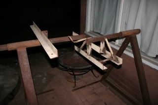

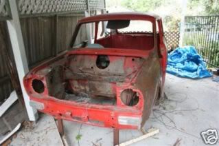

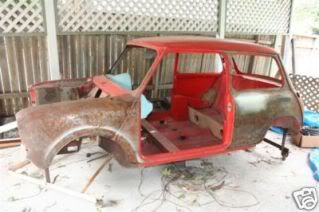

OK pics.. the first two are a little older but show the car on the stand on the wheels. The base sits in the subframe bolt holes.

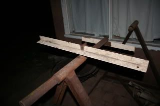

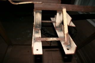

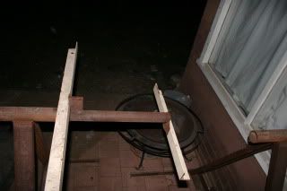

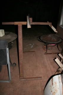

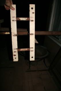

These pics I took tonight so sorry about the darkness. These are the stands. The front one is the wider one. The other is for the back. Once in the car rotates on the stands.
