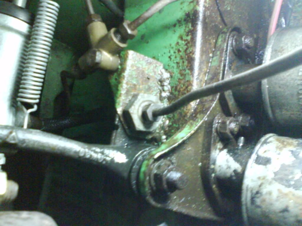

hey come one everybody has to learn somehow. Its not his fault it broke. Thing is, as the car as is, it passed blueslip - which is meant to be the "safety check" and all these things have gone wrong since. i think he musnt be much of a blue slip man.
First his brake line pipe was full of garbage which he fixed - should have been picked up in blue slip. Then he left his cap off by accident.. which consequently got air into it.....
Anyway i had a look for him (big brother) and this time it was not his fault (although spirited driving probably contributed). I had a look and somebody had bodged it before by the looks of it before he got it. It was bought complete and running and he hasn't done much to it at all.
It was the engine steady where it attached near the master cylinders had come loose.
Sorry about the isze of the photo - i couldnt be bothered reducing it :oops: :oops:

Quick hint, when you put it back together, put the bolt through so the nut is on the bottom. That way if the nut vibrates off, there is still a pin (the bolt) holding it. :wink:

Woohoo , I win , I said engine steady bracket :lol: :lol: :lol:

looks like its not the first time its come loose

ok i had a lot of fun yesterday with my car i pulled of the engine steady bar :) and welded a bracket to the fire wall to hold the engine steady mount there and i jacked the car up and my gear stick mount thing had been split in two so i pulled it off replaced it and then took it for a drive and perfect it is fixed yay
