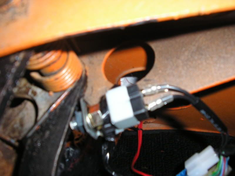

heres mine.. sorry its a crap pic, all it takes is a 90 degree angle bracket that you can actually buy from bunnings.. two 8mm bolts and a holden commodore (i think) brake switch... easy to fit.. except for drilling the holes.. if you could weld the bracket on it would be better.. hardest part is setting up the distance which takes about 30 seconds lol

Well, I put mine on, easy conversion, ran the wires from the pressure switch straight up and joined up new wires to extend back through the instrument panel hole and to the switch. Works great. Thanks for the advice Dr Mini, very happy with it. PS: don't worry about loose wire on connector, I re did it.
