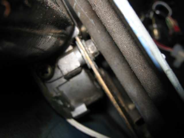

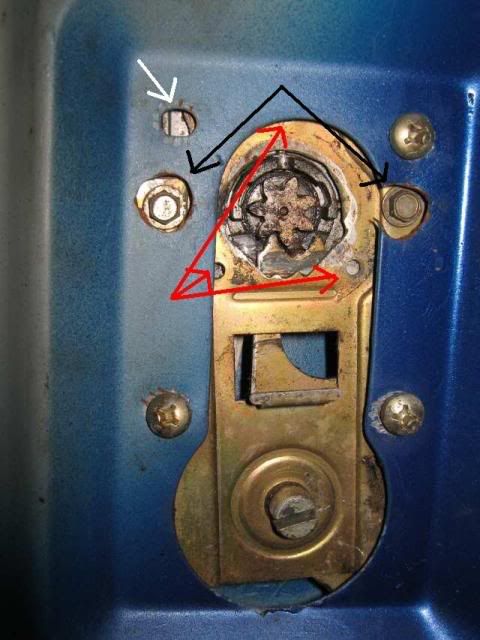

A little late but here are some quick pics, next time I have them out I’ll take more pics but you should give you the idea.
From memory I got the motors out of a Ford AT Telstar GHIA (around 1989 I think) but I think most Ford motors are the same from around that time.
Red – The old rivets that get drilled out to take off hand winder.
Black – two new holes drilled so you can unscrew the motor to get it in and out, it’s too balky with it on.
White – one screw gets left out.
The cog you see in the pic is on the motor and is close enough to the right size and pitch.
After you make a really nice door card :oops:
And two things that are a bit different :wink:
Nathan.

Nathan, not a bad install. Did you have enough clearance between the window and the motor? Did you have any problem getting the power and speaker cables into the doors (pics perhaps??)
Tricky
No there is enough clearance, the only problem is there are no limit stops so if you hold the switch down to long it will skip on the cog and do bad things like ripping the bottem C section off the glass :oops: I will take more pics of the cables tomorow and put up.

Brilliant - more pics please - especially of the window in the full down position with the door card removed.
Also, can you take some pics of how to did the wiriing through the door and into the door jamb.

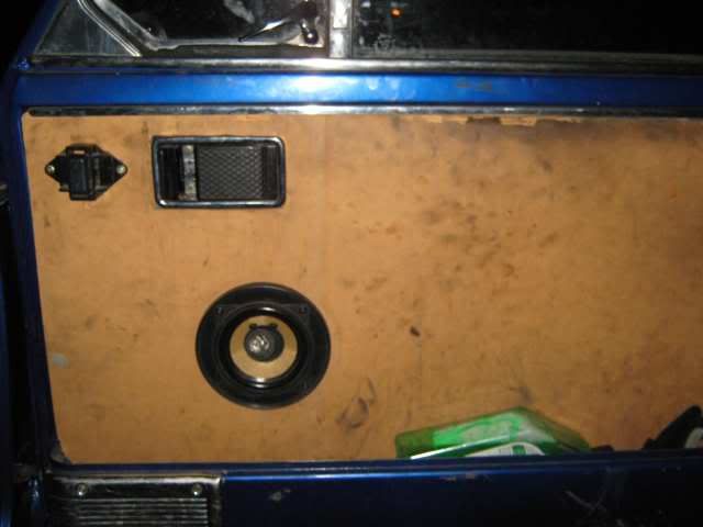

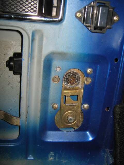

PostPosted: Sat Aug 01, 2009 5:41 pm
Finished, and they work beautifully.

Hi why do you have rivnuts around your door frame and what are they for Daren
PostPosted: Sun Aug 02, 2009 1:17 am
If you look at the second pic you will see the door card matches up to those rivnuts
PostPosted: Sun Aug 02, 2009 1:26 am
Exactly right Moke,
The nutserts are for securing the doorcard and thats about it.
