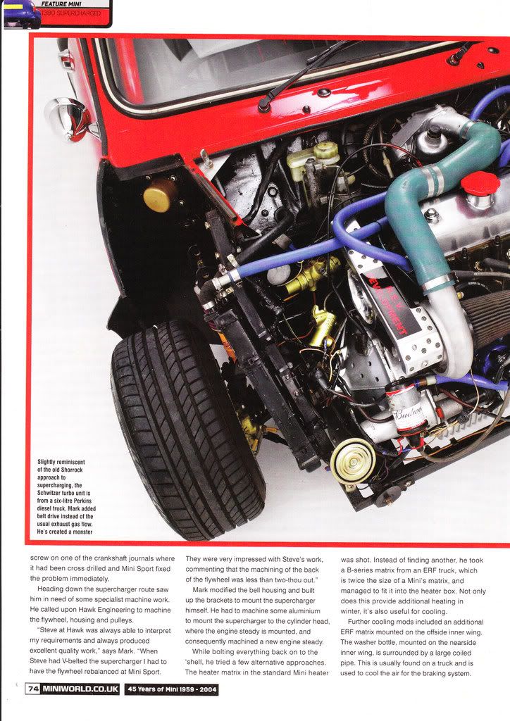

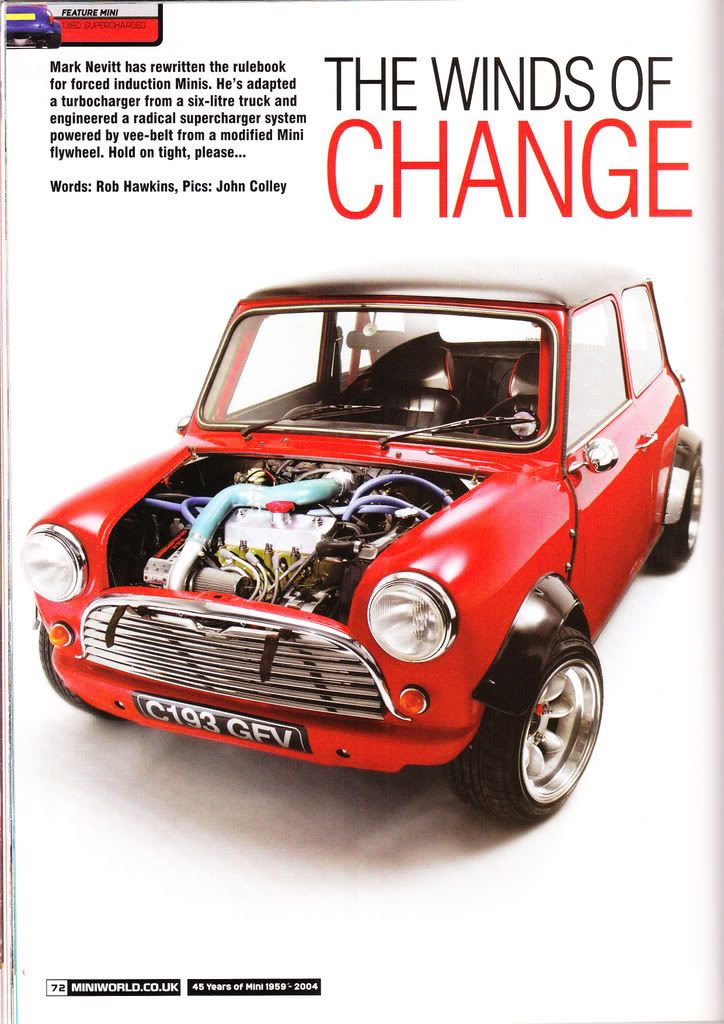

Thats the one i was thinking of. The way they said it, it didnt sound all that hard to do. Run a belt off the crank and mount it all with a bit of care and your sorted.

I reckon thats the one i saw, and thats a clockwise turbo facing the other way to what i thought i needed.....
Hmmmm.....
I can do that :D

and it's a blow thru system as well

I'm not keen on all the openings into the clutch area, what happens if you degrease your engine or you spill some brake fluid or oil :?: no more clutch that's what happens.
But with saying that it still is an impressive build.
