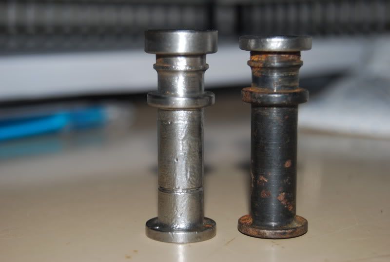

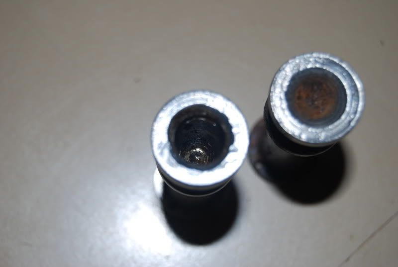

Well I've found a 0.75" cylinder, and ordered a kit. Hope to get it sleeved soon, but in the meantime, I've found these two 0.75" pistons.
Any ideas on which one to use, or why there are these two variations?
One is sllightly longer and has a much, much deeper land for the push rod to live in.
Thanks for any tips.
