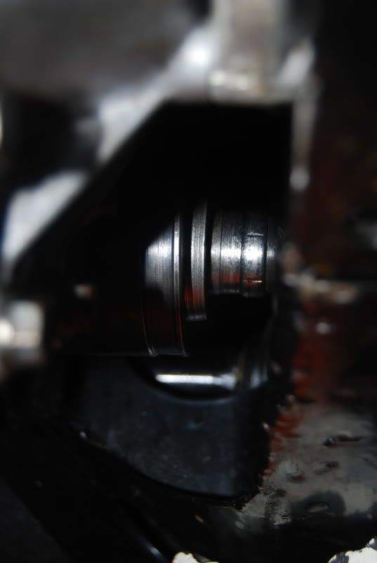

I just had another look, and the driver's side drive shaft is fitting properly - I can't even see the ball bearings in the pot joint, no matter what position I put the suspension in. GT Mowog's idea is a good one, and I have a drum upright & CV to check with. Along similar lines, I'm going to compare measurements between my car and my dad's - gearbox to subframe, and subframe to CV. I actually suspect that the CV joint is the wrong one - ie too short.

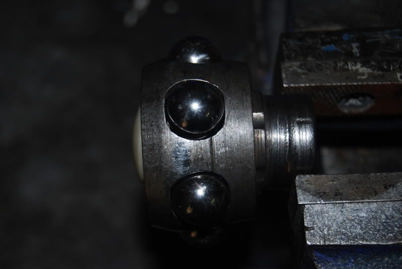

I think I have it sussed, thanks to all for input from Ausmini and a couple of ACT Mini Car Club bods. It seems I have to put my hand up as a duffer - I had the ball race installed back to front in the pot joint, as the pictures clearly illustrate.
Also, I'm told the balls don't sit too far into a correctly assembled joint anyway, so small error was enough to cause grief. Probably only a matter of 8mm or so...

Yeap, that I would say is part of the problem. I'd say that will probably get 'engaugement' but only on the very edge of the outer 'bell' of the CV. Remember (as you pointed out in your pics) that the deepest it will be is when the drive shaft is straight, as the suspnsion moves up and down, the drive shaft will move out and could still lead to dis-engaugement.
EDIT> The balls do sit in about 10 to 15 mm. Have you ever 'felt' a worn CV? That will give you a guide as to where the balls normall run.

MattE,,, sorry to post soo late onto this one (been on holidays :-) ) but reading through it, i felt like the ball race was on the wrong way round, (very common mistake) then i saw your pics of it sitting just outside the pot & it`s quite clear in that first shot/pic that the race is definately on the wrong way round
that`s the problem,,,, so swap it over & you`re away easy-peasy
