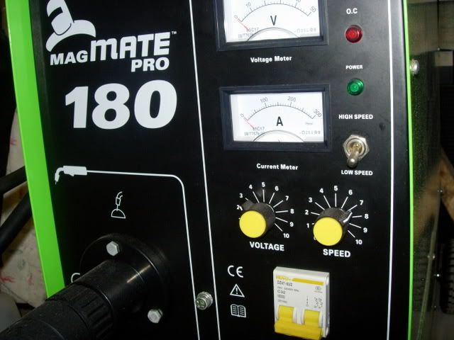

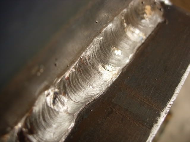

I have one (but not sure if it is an inverter?):
Haven't done alot of work with it (Moke resto about to start!) but the welds come out OK (subject to the DR's closer inspection)
Dave K.
PostPosted: Fri Jan 22, 2010 6:25 pm
Posts: 39757
I can't tell from the front panel, does the V knob have 10 steps or is it an infinite adjustment?
If it has switch steps, it's NOT an inverter. If it's continuous, it could be, or else it's a thyristor controlled transformer like mine.
:idea: Pick it up, if it's a heavy sucker it's NOT an inverter.
Just looked up the brochure and it is an inverter (voltage is infinite adjustable):
https://boc.com.au/boc_sp/downloads/Ind ... ochure.pdf
Dave K.
