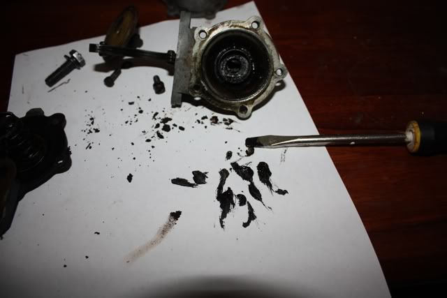

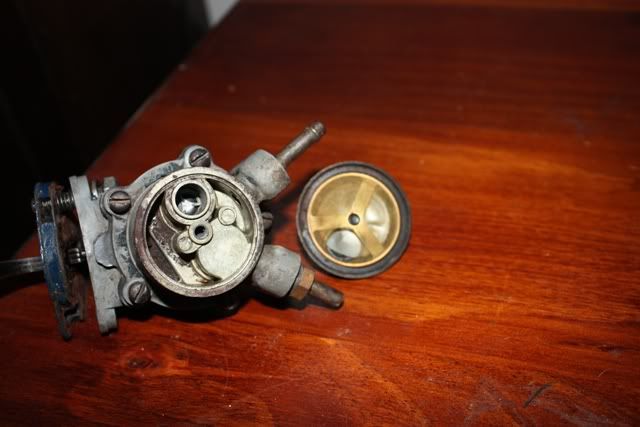

when i bought it the owner told me the pump was broken, i didn't ask why. I just looked up replacement price and it seemed pretty cheap, so i just got one. now that i have it off i can tell you that when you pump the arm, it does not seem to be making any pressure on either inlet or outlet.
i have done as you sugested and taken some pics.... see if you can diagnose the problem. :)
Top off
Nothing too serious looking here. just a bit of crap in the bottom
However after pulling the next bit off
the bottom is full of greasy crap.
thats the stuff on the paper
Could the spacer be the problem???
It has peices broken in the corners and has several noticable cracks

The buggered spacer would have not helped things but shouldn't have caused it to stop pumping.
Show us some pics of the diaphragm and the little flap valves. If the diaphragm has any cracks/holes or the valves are badly worn/plugged with crud then they wont pump.
