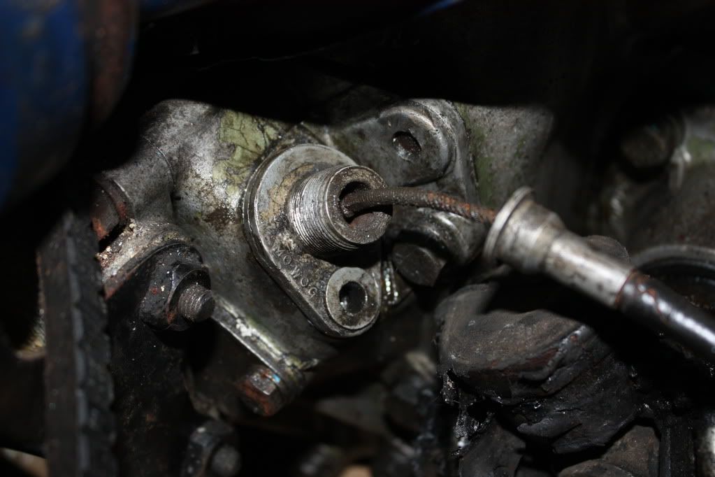

Ok i was bored this afternoon and got back to trying to fix this old problem. It is a little easier to see now the engine is out.
I have put a fair bit of leaverage force on the thing to get it out, but it just seems to be stretching the cable, not moving the rest at all.
The end of the cable is welll and truely siezed into the end of the boss, and the boss dosn't seem to be moving either.
I have sprayed some penetrating oil down in there to soak, so i'll see if that does anything.
Such a pain in the ass.... :evil:
