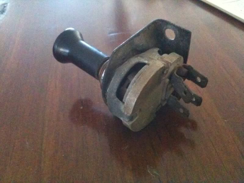

Well I've scored a potentiometer from jb007 (Thanks a million Jim). I'm unsure at this time if I should use it or not however pending a few questions.
So if the switch is under the bonnet, am I to assume that the driver chooses to operate the heater at the beginning of the trip and leaves it on? The heater flap modulates the flow? Am I supposing that some markets/models had the potentiometer fitted, and others just had the switch?

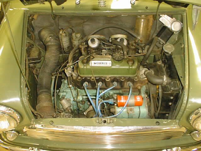

As far as I know none of the 997 Coopers used a rheostat to control the heater speed. The heater tap is the top hat type shown in the pics although I have seen the brass tap type in some very early photos.
With the 997 Cooper with the blower in the engine bay it is switched with the switch directly below the ignition switch. Check for the 2 mounting holes in the lower dash panel at this point.
The switch panel has the air control cable at the LH end and the heater tap cable at the RH end of the switch panel. The choke cable is mounted next to the steering column (see pic) and the windscreen washer pump is mounted on the LH side of the dash.
I have the original loom and there is no provision for the rheostat. The heater fan is simply switched and a separate loom runs from the switch directly to the fan motor.

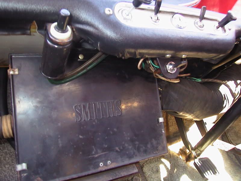

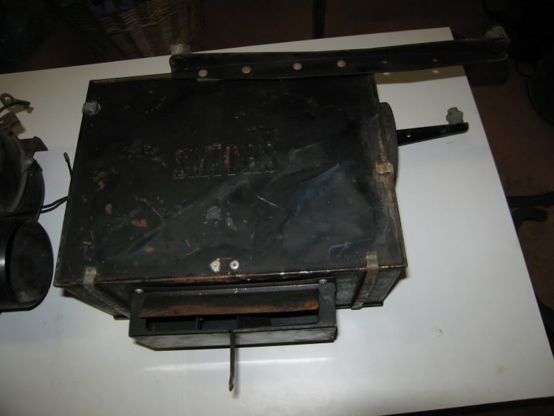

My English 997 uses a different heater than the Aussie ones it is a square box with the motor built into it my Aussie one is what wild willy's describing
PostPosted: Thu Dec 30, 2010 5:46 pm
Posts: 637
The pics are from an early English 997 Cooper. Sounds like your may be even earlier Gold-brocade. I know the very early Smiths heaters sold as a kit for the 850's used a square box heater with the fan built in. Any chances of some photos of your English set up?

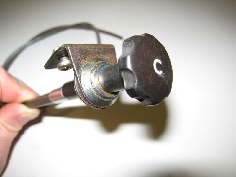

I have a crinkly knob too!:

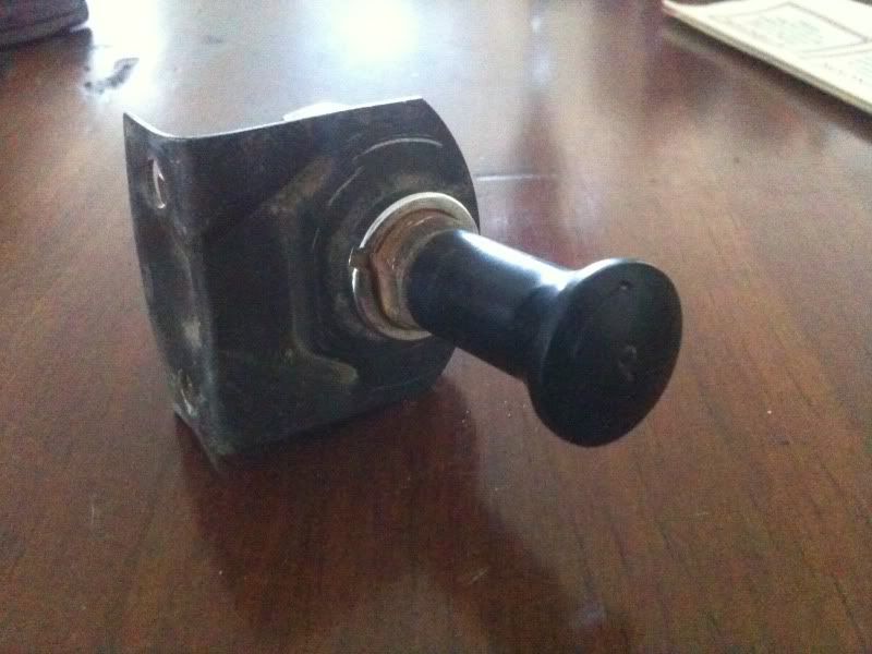

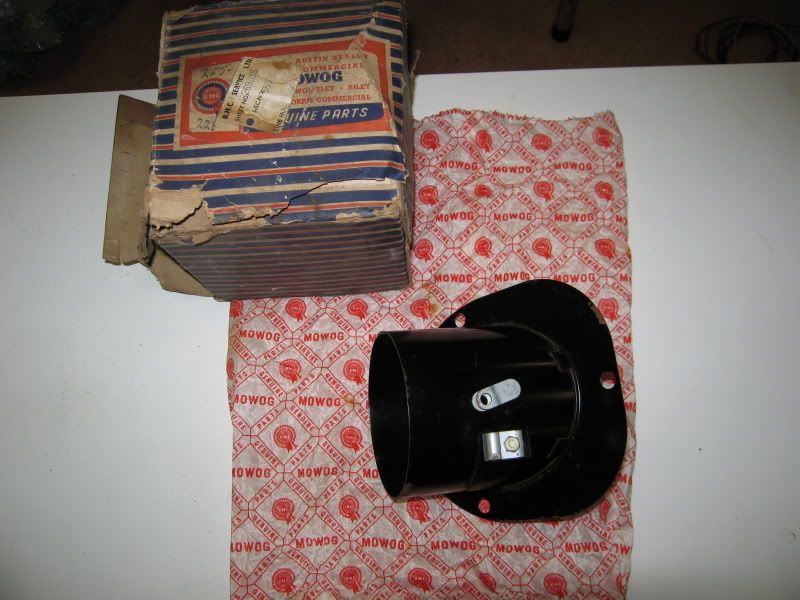

No rheostat that I know of, only the switch as described by willy:

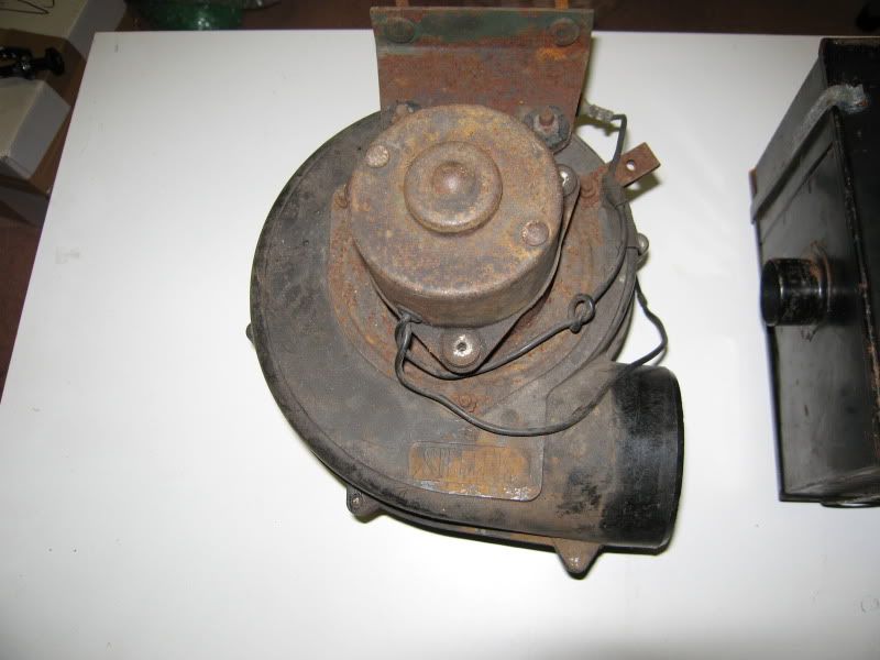

My Blower:
My Heater:

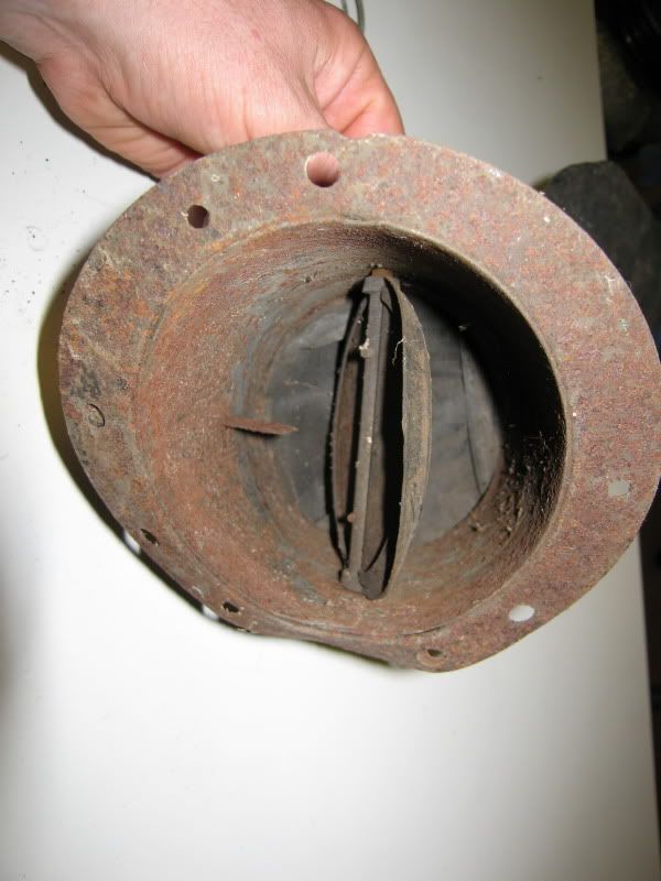

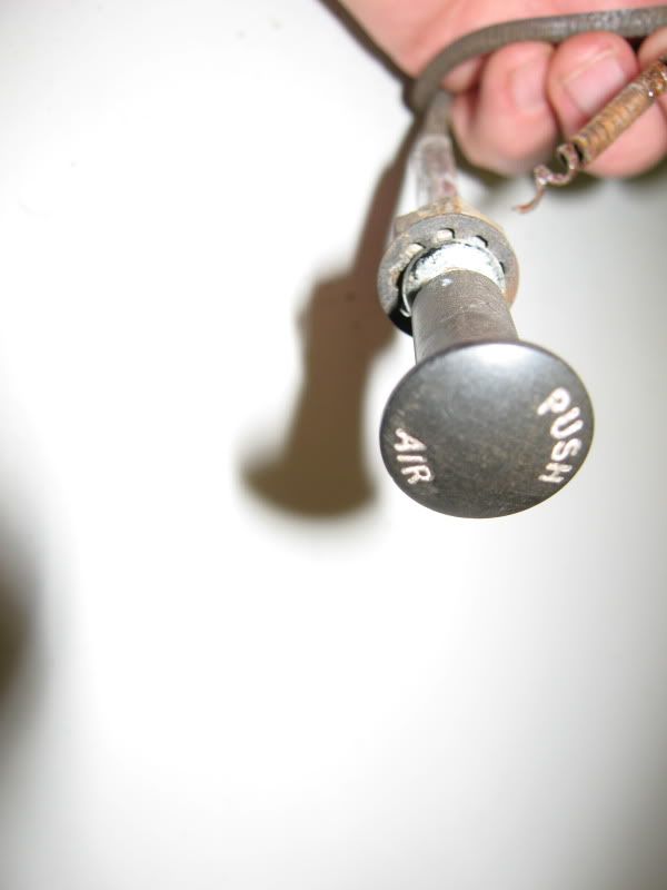

Mine has a 'Push Air' Cable:

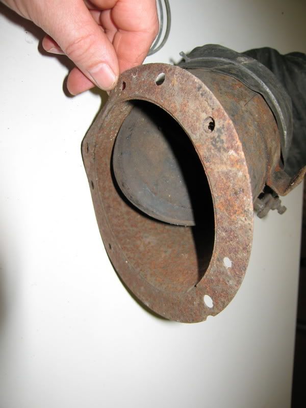

Original Flap Valve:
