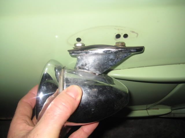

NSW Police used different types of Wibroc external mirrors. The main one was as you see fitted to the wrecked S on the trailer. It slid over the leading edge of the drivers door and had two grub screws that may have left a mark along the seam where the outer door panel folds over the inner above the top hinge. They also used the Sportsmans mirror (Bullet shaped racing mirror). Your holes look like the latter has been fitted.
I'll post some photos later.
I don't have any holes for Wibroc mirrors. Here are photos of the holes in the doors, plus the mirrors that were on the car when I got it. There is obviously an extra hole. On the passenger side, that extra hole is from a "grub" screw, i.e. not drilled/stripped like on the driver's side. Am I correct that a "grub screw" is what we'd call a sheet metal screw--sharp point, coarse thread, used to just make a hole and grab metal at the same time, no nut for the back?

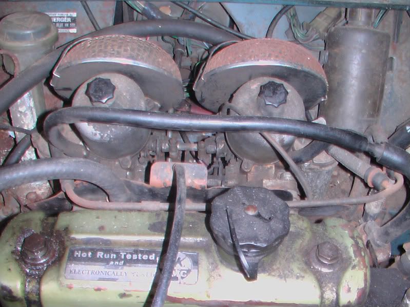

bmacpiper wrote:
I do have a few questions for now.
Carbs--I have the set on the car, and another rebuilt set. The rebuilt ones are non-cooper, but wonder what they're from. On the car are numbers AUC870 and AUC871, with tags that have AUD146L and AUD146R on them. The rebuilt ones have AUD146L and R, but are numbered AUC8450 and AUC1342. They also have vacuum takeoffs which I don't think should be there. Any thoughts on what the numbers tell me about these four carbs?
They're not the original carbs, and they are made up of bitza carbs from other applications. The carb tags are I believe correct for a pair of MK2 S 1.25 carbs, so don't lose them at any cost. Its just the carb bodies which are not the correct casting numbers. The 1342 would normally be paired with a 1341 on a sprite I believe, and AUC8450 is a standard 1100 mini/moke carburetor. The vacuum takeoffs for vac advance dizzies (not fitted to Cooper S obviously) are usually fitted to the twin carb closest to the clutch. That is why the 1341 has a vac take off, as well as the standard 1100 carb.

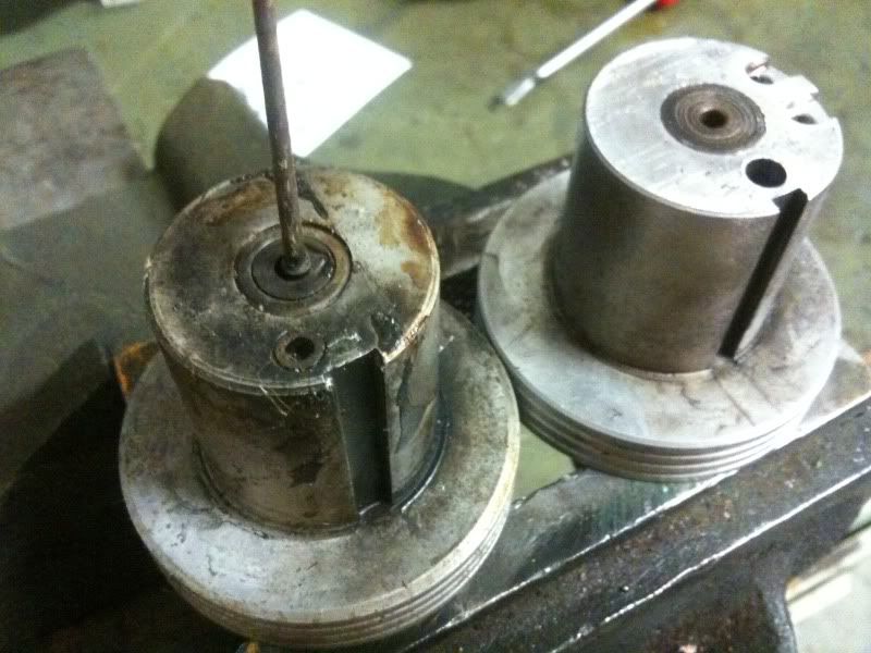

If you take off the dash pots, you will notice that the pistons may differ from right to left. The two pistons you may find are in the image below. The piston on your right is a twin SU piston, with two breather ports. The piston on the left is a standard SU piston with no ports. Both carb inlet throats should have a cut out for a port on the front face of the carb body on both sides. A standard throat has it on one side only.

Just pulled the dash pots, and you're correct. The 8450 is like the left one in the photo, the 1342 is like the right one. Does this difference change performance of the carbs when they are used together as a pair? You may recall that they were quite nicely rebuilt, and my reason for purchasing them was to get the mk2 airbox attached to them. I'd like to sell them again at some point (I'm rebuilding my own set, i.e. the 870/871 and/or looking for 1.5s), but I don't feel it's right to advertise them as Cooper S carbs when they're not. I wonder if they are effectively the same thing or not?

With the exception of the pistons, they are functionally the same. The differing pistons will have an effect in transition, how much I could not tell you. I would expect the extra ports on the twin damper pistons perhaps improve response times to changes in load. I can't see an unmatched pair being a good thing, one piston will operate differently to the other in an identical situation. How much of a difference it makes in actual operation I would only be guessing.
