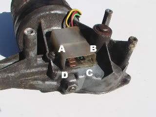

A two-speed wiper motor has four spade terminals visible whilst a single speed motor has only three. Yours appears to be single speed which seems right for the date of your car. See photo below of two-speed motor connectors.

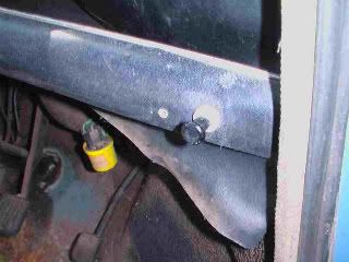

The driving light switch on my car is in a hole drilled in the front edge of the parcel shelf on the driver's side (see picture below). I can give you specifications for the Hella switch and cable size if you wish. Personally I wouldn't be drilling a hole here for your driving lights if it's not there already. I believe some cars may have had a small switch panel screwed to the upper crossrail lip under the windscreen for siren and driving light switches. Holes in this area is another indicator of police specification as the tachometer bracket was bolted under this lip in front of the driver.
Thanks for the pic. I agree that mine is single speed, but not sure about the date question. I have requested the SPO's and SL's from Watto, perhaps he has them and they may shed some light on the question. And/or might you have them in electronic form?
Don't have that hole, and won't be adding holes at this point! I do find two cross-head screws with a plastic tab under/between them in approximately that location under the shelf, and a couple of unaccounted-for holes. The screws/tab "feel" newish, i.e. I don't think they date back to police days. The other holes appear older, i.e. with a bit of corrosion, etc. Pictures another day. The two holes under the top lip are present, as previously discussed, slightly to the right of the centerline of the steering wheel. They could be the switch panel you describe, or a tacho--though they'd be a little odd location for a tacho, as the tacho would be a little behind the wheel on the right and partially obstructed from view.
