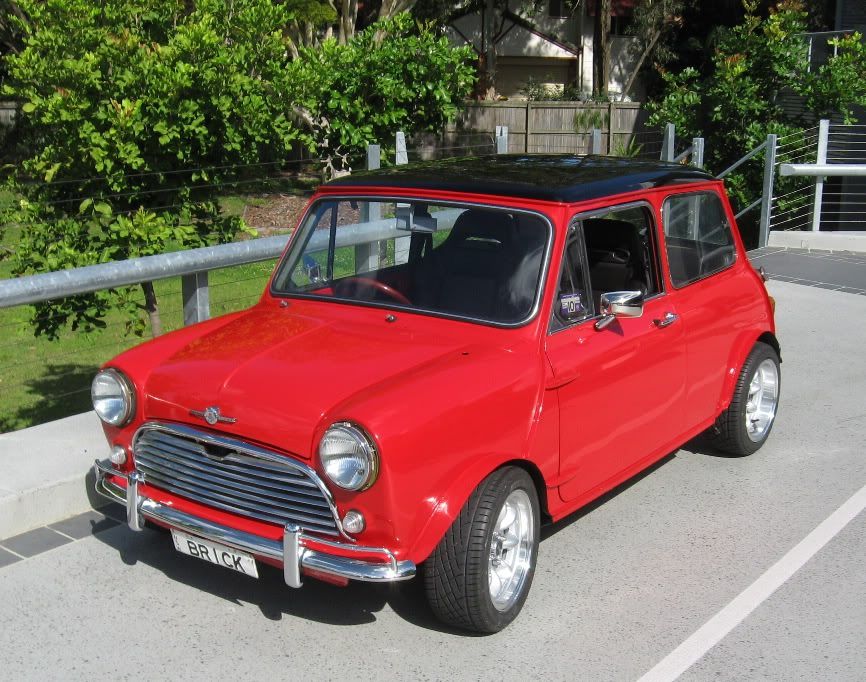

5x10s fit nice under your Inno flares. 6x10s (unless they are GBs then maybe not) will stick out, you will need wider flares.
Here's mine with 5x10 Contessas and Innos...

With those flairs I'd stick to 5" wide rims.
This S has 6" mambas with I think 165 tyres.
In the top pic the hydro is blown but the bottom pic gives a good idea of how they fit.
The tread is under the flair but the sidewall and rim are slightly out.
