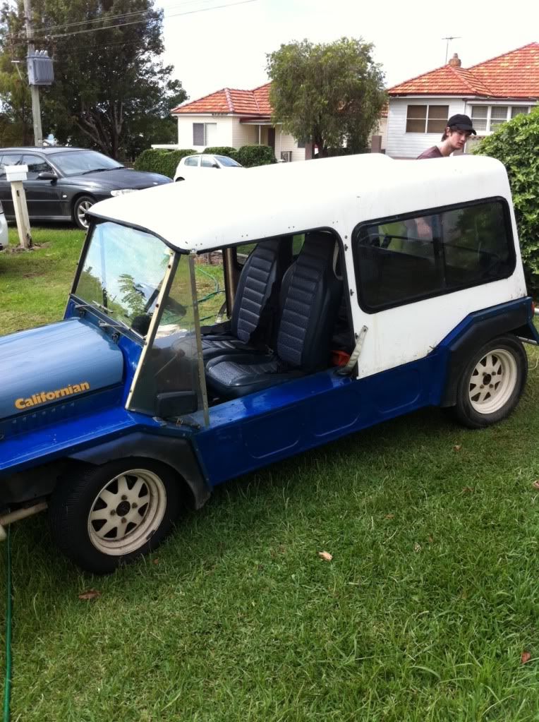

Well after no rain in Sydney for 5 weeks, Moira was all set and ready for her big trip to Newcastle. We packed her up with tools, fuel, oil, water and coolant as well as rope and all the other stuff thats important for a big drive in a Mini/Moke.
At 6.30 am we woke to rain. LOTS and LOTS of rain. 20 mins later, her canopy (sans sides) was on and by 7am we set off. It basically rained THE WHOLE WAY to Newcastle where just as we turned into the suburb we were goign to, it stopped.
We spent some time fitting the roof......
It went on perfectly, although there were no mounting points on my car for the roof, so out came the 20m of rope and we tied the roof down. Then we started her up and off we went back.
We drove out of Newcastle and then it started raining. MORE and MORE rain. Heavy rain. The roads were slippery and we thought about stopping, but we pushed on getting back home SOAKED from being splashed by other cars and from water pouring in up over the windscreen and under the roof (the rubber seal that connects under the roof on top of the windscreen was missing)
Anyway, 2.30 and we were home and let me just say, I LOVE MY NEW ROOF....
It has these two perspex doors which cover the entire side that is open int he above pic, so with the windscreen seal and doors, its gonna be a nice dry rainy winter for me in my moke..!! :lol: :wink:

oh and PS... after spending 3 hours removing the roll cage, we actually worked out this roof slipped straight over the californian roll cage, so guess what I will be spending 3 hours putting back in............ :lol:

Adam... yeah it will go straight over the top of the roll bar without any problem so I am putting it back on. Although Aaron just gave me the number of a guy I will call because he can maybe fabricate one for me which will be stronger and more appropriate than what I have.
But yeah its totally awesome. Just have to mount it properly so i can remove the ropes.

OMG Tim dont say that. This thing was waterproof totally when the moke was standstill, 98% waterproof going at reasonable speed with reasonable rain (ie 60km/h with light showers) and 50% waterproof at faster speed with torrential rain (ie 100km/h on the freeway with it bucketing down).
The most water came in between the front of the roof and the windscreen, but the guy i bought it off said there is meant to be a rubber tube which goes across (i can see the old glue lines) which stops water blowing up there and also stops it rattling on the window). Im sure to get something from clarkes rubber that will do the trick...
The day was a good day to compare because we went up with soft, came back with hard... and although its ugly as sin and does take away some of that open wheeler appeal the moke has, it is pretty functional.
