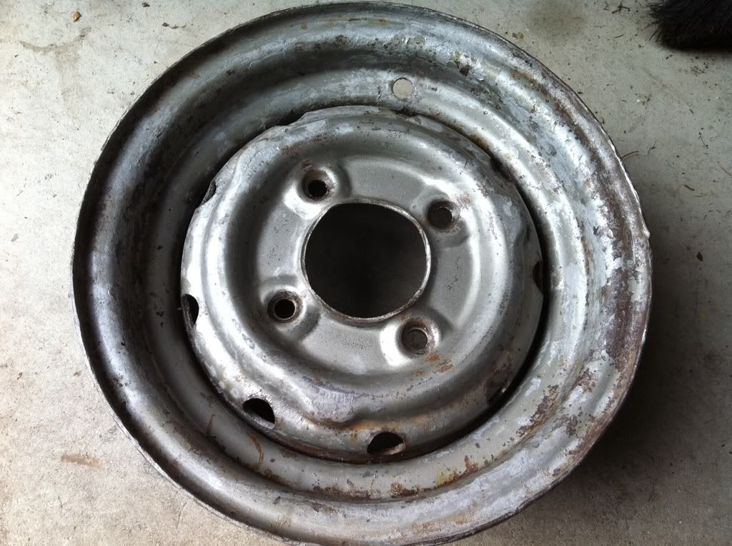

Ok I am in the process of getting some original Cooper S wheels repainted, I have 4 I bought privately, plus my original spare.
As I strip back the various coats of paint added over the years they all have the same colour underneath. In fact I would call it more a grey with a green tinge.
When I compare it to my switch panel in the car it also looks to have the same green tinge.
Going off Winabbys original paint charts in the "How to" section 13260 is Listed for the wheels in the BMC chart. This seems to be the one with the green tinge.
The Dulon refinish chart shows shows 06968 as the wheel colour. Who has used this? Is it more of a bright silver?
Why two different codes? Where does the truth lie???
Heres a Pic of my wheel, someone had painted this wheel with wheel silver
like you get from repco, still some round the rim. Original colour in the centre.

I've used both colours for wheels. 13260 is way too green
06968 is the correct one for pre-72 cars, 13260 is '72 onwards

So would you say 06968 still has a green tinge and 13260 has more of a green tinge.
I'm still confused because the BMC charts seem to contradict the Dulux charts.
Maybe the BMC chart is a misprint?

hmmm..... well, best answer from me is
comparing the wheels that I've painted myself with the paint I had mixed up from my local paint shop using the formula they have on their computer
putting the two wheels side by side, 13260 definitely has more of a green tinge, and it makes the 06968 look quite silver; however if I put a piece of raw aluminium next to the 06968 wheel, you would say it had a slight green tinge
