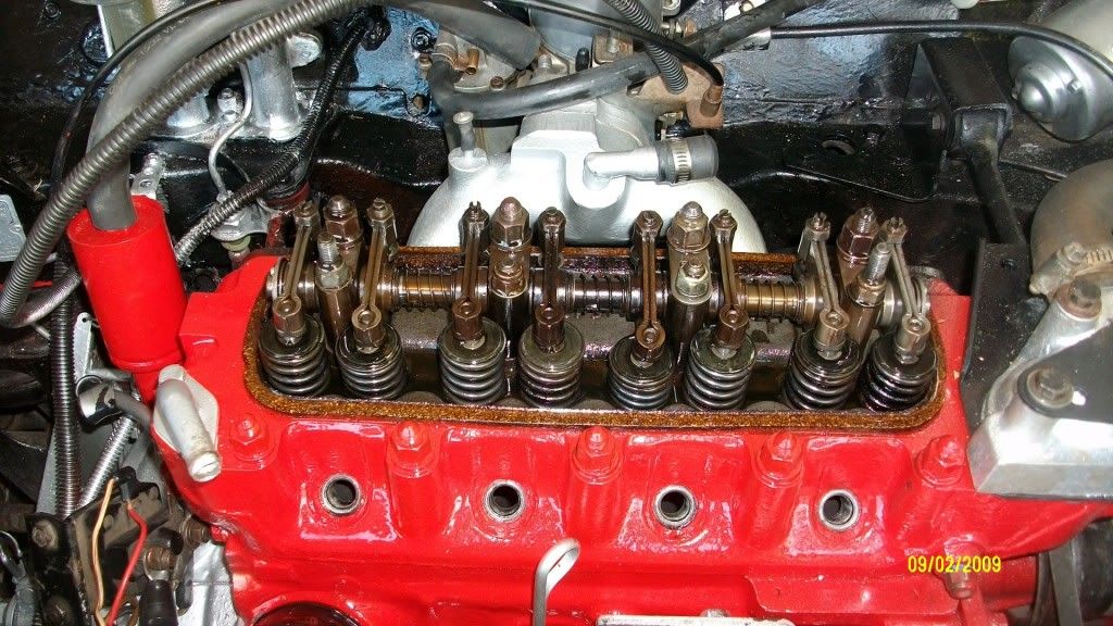

Ok, well i pushed the car in 4th gear until i could feel air coming out of the number 1 spark plug hole - does this mean its on compression stroke?
Do the rockers look in the right place to you?
PostPosted: Wed Apr 06, 2011 3:55 pm
Posts: 840
On page 1 Mike gave you the tip for working out TDC.
turn the engine over with the rocker cover off. #1 will be at TDC when :
- both its valves are closed
- BOTH the valves on #4 are moving (exhaust closing, intake opening)
It's very hard to tell from your latest photo if the valves are open or not.
Then once you are certain you have TDC, line the rotor up with the lead going to #1, and then re-cable as per normal.

PostPosted: Wed Apr 06, 2011 4:41 pm
Posts: 3635
Location: Gulgong
Ryan
I know you are struggling with this and probably getting very frustrated with it all. However, the car was running and nothing has been changed bar the leads and now the plugs.
Getting the leads on properly is important and you have to know the difference between top dead centre on the exhaust stroke and top dead centre on the firing stroke. You need the piston in number one to be at its highest point on the firing stroke with both valves closeed and the valves on number four opening and closing. Pistons two and three should be at bottom dead centre.
In the photo - I think I can just see a reflection of pistons 2 and 3 - which means nothing is in the right place if I am correct in what I can see.
Pushing the car backwards and forwards in gear with the plugs out is a good as anyway to find TDC. But make sure its the firing stroke and then replace the leads as several of us have already described.
Mike
