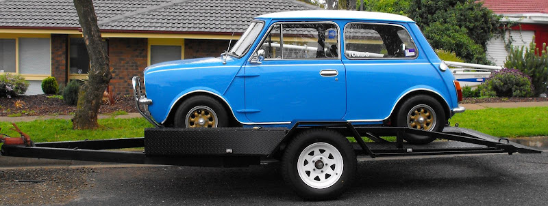

It already has a winch (since the below photos were taken) but that won't change anything.
The trailer bed rocks over its axle so for it to go flat the centre of gravity of the mini (where the jack holes are) needs to go forward of the trailer axle, the issue with backwards mini on mine would be the back wheels of the mini would fall off the front of the bed before the weight gets far enough over the axle.
CLICK HERE FOR VIDEO
Its a bit wider than nececary but i just built the bed to suit the axle i had, theres about 15 - 20cm clearance each side.
You see in the bottom pic why i like the idea of removable guard tops 8)

awesome looking trailer Tombo, i like the inbuilt storage boxes in the front sides too.
you could hinge the top of the guard from the front of the guard, so all you have to do is fold it over?
have always liked the concept of the tilt trailer, just never spent enough time under one to fully grasp the concept of the pivot points etc... i think for my needs if i ever build one, it'll have a flat floor so i can use for landscaping needs, tip out loads of mulch and compost etc, then haul the mini when needed :)
Hehe, i pinched the storage box idea from Mad MkI's awesome trailer :wink:
I thought hinge too, but it would hinge to the back with a latch inside the toolboxes.
And as for the complete floor, i have that covered with a removable centre, helps with working on the mini and saves about 100kg when removed.
One issue i had to deal with is weighting the front of the bed because i put a ute type wind up spare wheel holder under the front of the bed, that stopped it from tilting on its own so theres a light spring under it to help.
And it has a pair of car shocks in the tilt to soften the movement, it's stealth now 8)

Tombo wrote:
weevel wrote:
could you just add a winch?
Love this trailer!
Question 1) Is no suspension an issue?
Question 2) How much (to have made)?
PostPosted: Wed Jul 06, 2011 3:56 pm
You can always add a plank to the drivers side trailer floor to lift the car a little to get door clearance.
I prefer suspension on a trailer. It makes a huge difference.
PostPosted: Wed Jul 06, 2011 5:39 pm
Tomboss Breweros
Posts: 7514
1. It does have suspension, 1.5 ton springs with about 3 inches travel unloaded, it has bout 2 inches with a mini on.
2. Including buying the donor trailer it came to about $1800.
The donor trailer was tandem unsprung and was a bit of a pig.
