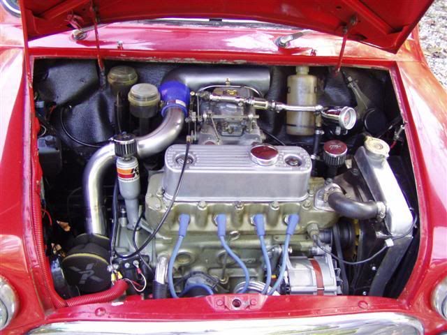

I'm running a 45 DCOE, with the ole cut out firewall trick and I just removed the heater and re-routed the air intake from that to a cut out to the new box section. Its not really the temperature issue it's the availability of air, and with the carbie jammed back in the firewall there isn't a lot of circulating flow and you can choke the larger inlet carbie set ups.

there was a discussion over on PF that brought this to my mind, but regarding MX5's and their intakes being right up against the firewall and reverse cowl's on V8's;
apparently the base of the windshield is a high pressure zone - it's why the intake for your cabin aircon etc is there - so you'd be better off trying to draw in air from there?

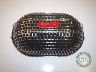

PostPosted: Sat Aug 27, 2011 12:35 pm
Posts: 722
Location: melbourne vic
this is what I did on my lasty min.
work ok...made it a bit quitier..
no real power gain..lol it just looked different.
i used a ram flow air filter as a template.
cut a hole shape in the mesh part to hold the piping...i used plastic pipe...
hot melted it into place..
i then covered the whole thing in cloth streched it over to get a nice shape hot melted the edges to hold it in place and then fiberglass resined the hole thing to make it go hard
I then used fiberglass to make it hard and strong and protect it from the heat...
....undercoated it...painted it...
job done. ...
there was a how to do this ages ago but links dont work now ..
